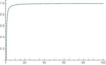

Let $\iota=(1,\ldots,1)'$ (the $n\times 1$ vector with entries all $1$). Let $X=(X_1,\ldots,X_n)$ and $M=I_n-\iota(\iota'\iota)^{-1}\iota'$. It's easy to verify that $M$ has rank $n-1$ so $$ \frac{n-1}{\sigma^2}S^2=\frac{1}{\sigma^2}X'MX=[(X-\mu\iota)/\sigma]'M[(X-\mu\iota)/\sigma]\sim\chi^2_{n-1} $$ the $\chi^2$ distribution with $n-1$ degrees of freedom. So $\sqrt{\frac{n-1}{\sigma^2}S^2}$ has the $\chi$ distribution with $n-1$ degrees of freedom. It follows that $$ E(S)=\frac{\sigma}{\sqrt{n-1}}E\left[\sqrt{\frac{n-1}{\sigma^2}S^2}\right]=\frac{\sqrt{2}\sigma}{\sqrt{n-1}}\frac{\Gamma(n/2)}{\Gamma((n-1)/2)}. $$ Note that while $S^2$ is unbiased for $\sigma^2$ (as indicated by some other answers in this thread or those given here), $S$ is not unbiased for $\sigma$. Indeed, you can plot $\frac{\sqrt{2}}{\sqrt{n-1}}\frac{\Gamma(n/2)}{\Gamma((n-1)/2)}$: enter image description here
As you see, $\frac{\sqrt{2}}{\sqrt{n-1}}\frac{\Gamma(n/2)}{\Gamma((n-1)/2)}$ approaches $1$ as $n\to\infty$ but it is nonetheless not $1$.
