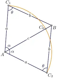

Consider points $A,B,C$ as vertices of $\triangle ABC$ with $|AC|=a$, $|BC|=b$ and $\angle ACB=\theta$.
Let $c=|AB|=\sqrt{(x_1-x_2)^2+(y_1-y_2)^2}$.
Note also that $\theta$ can be found from $a,b,x_1,y_1,x_2,y_2$.
The sought point $C$ can be found by rotating the point \begin{align} C_0&=A+(B-A)\cdot\frac{a}c \end{align}
around the point $A$ by the angle $\pm\alpha$.
There is no solution, if the numbers $a,b,c$ does not form a valid triangle, otherwise there are two solutions, (unless $\sin\alpha=0$): \begin{align} x_0&= x_1+\frac{a}c\,(x_2-x_1)\cos\alpha-\frac{a}c\,(y_2-y_1)\sin\alpha ,\\ y_0&= y_1+\frac{a}c\,(y_2-y_1)\cos\alpha+\frac{a}c\,(x_2-x_1)\sin\alpha \end{align}
and
\begin{align} x_0&= x_1+\frac{a}c\,(x_2-x_1)\cos\alpha+\frac{a}c\,(y_2-y_1)\sin\alpha ,\\ y_0&= y_1+\frac{a}c\,(y_2-y_1)\cos\alpha-\frac{a}c\,(x_2-x_1)\sin\alpha , \end{align}
where \begin{align} \cos\alpha&=\frac{a^2+c^2-b^2}{2ac} ,\\ \sin\alpha&=\sqrt{1-\cos^2\alpha} . \end{align}

  • Hi, again. Where could I find the step by step derivation/proof of the C0 = A+(B-A).a/c formula. Also the x0,y0 formulas which follow. Thanks in advance! – Vishnu Prem May 21 '18 at 11:31
  • @Vishnu Prem: Given point $A$ and vector (direction) $B-A$, we can find point $B$ as just $B=A+(B-A)$. The length $|B-A|=c$, thus $(B-A)\cdot\tfrac1c$ is the vector in the same direction, but with unit length, and $(B-A)\cdot\tfrac{a}c$ is the vector in the same direction, but with length $a=|AC_1|=|AC_0|$. Then $A+(B-A)\cdot\tfrac{a}c$ gives $C_0$. – g.kov May 21 '18 at 14:48
