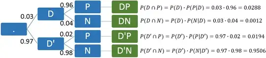

Refer to the probability tree diagram (D-take drug, D'-do not take drug, P-positive, N-negative): enter image description here
a) $P(D|P)=\frac{P(D)P(P|D)}{P(D)P(P|D)+P(D')P(P|D')}=\frac{0.0288}{0.0288+0.0194}=0.5975.$
b) $P(D'|P)=\frac{P(D')P(P|D')}{P(D')P(P|D')+P(D)P(P|D)}=\frac{0.0194}{0.0194+0.0288}=0.4025.$
c) $P(D|N)=\frac{P(D)P(N|D)}{P(D)P(N|D)+P(D')P(N|D')}=\frac{0.0012}{0.0012+0.9506}=0.0013.$
d) $P(D'|N)=\frac{P(D')P(N|D')}{P(D')P(N|D')+P(D)P(N|D)}=\frac{0.9506}{0.9506+0.0012}=0.9987.$
