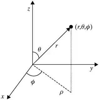

Now recall the spherical coordinate system, as is shown in the following figure. The tricky part is, we can always reconsider the coordinate after the tuple $\left(\theta_0,\phi_0,u_0,v_0\right)$ is given. That is, as $\left(\theta_0,\phi_0,u_0,v_0\right)$ is specified, we perform a transformation, making this $\left(\theta_0,\phi_0,u_0,v_0\right)$ appear to be a vector at the north pole pointing parallel to the $x$-axis in our new coordinate system. Therefore, in our new system, $\theta_0=0$, $\phi_0=0$, $v_0=0$. Plus, to keep the normality of the velocity, let $u_0=1$.
Consequently, our system becomes \begin{align} \ddot{\theta}-\dot{\phi}^2\sin\theta\cos\theta&=0,\\ \ddot{\phi}+2\dot{\theta}\dot{\phi}\cot\theta&=0,\\ \theta|_{\tau=0}&=0,\\ \dot{\theta}|_{\tau=0}&=1,\\ \phi|_{\tau=0}&=0,\\ \dot{\phi}|_{\tau=0}&=0. \end{align} In addition, to show that the solution corresponds to a great circle, it suffices to show that the above system implies $\phi\equiv 0$ (or more rigorously, $\phi\equiv 0$ when $\theta\in\left[0,\pi\right]$, and $\phi\equiv\pi$ when $\theta\in\left(\pi,2\pi\right)$).
