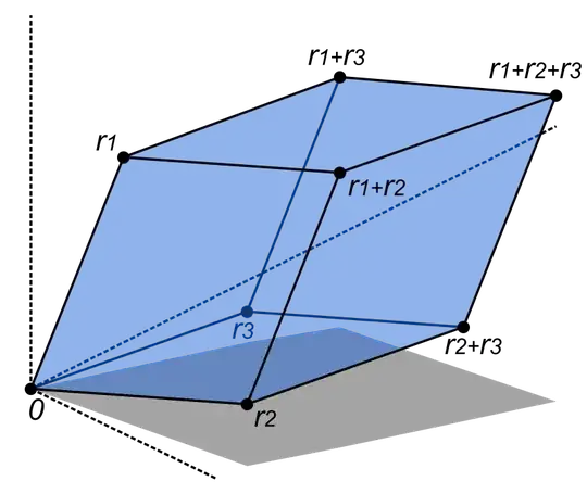

In 3d the absolute value of the determinant corresponds to the volume of the parallelepiped formed by the rows constructed from the vectors $r_1$, $r_2$, and $r_3$.
Since the determinant is equal to the triple product $$r_1\cdot (r_2\times r_3)$$ without absolute value the determinant can be negative or positive depending upon the orientation of the row vectors.

  • More precisely, in the 3d case, what happens to the vectors that shape the parallelepiped when the sign of the determinant is negative ? – Qwerto Apr 05 '18 at 06:02
    @Qwerto since $det(r_1,r_2,r_3)=r_1\cdot(r_2\times r_3)$ the sign depend by the direction of $r_2\times r_3$ with respect to $r_1$. In the figure here above $r_2\times r_3$ is up and thus $det(r_1,r_2,r_3)>0$ otherwise $det(r_1,r_3,r_2)$ is negative. See also there https://math.stackexchange.com/questions/314275/scalar-triple-product-why-equivalent-to-determinant – user Apr 05 '18 at 06:52
