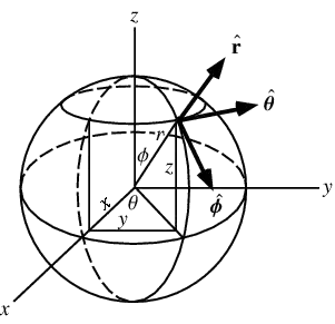

Let use spherical coordinates with
  • $x=ra\sin\phi\cos\theta$
  • $y=rb\sin\phi\sin\theta$
  • $z=rc\cos\phi$
and with the limits
  • $0\le \theta \le \frac{\pi}2$
  • $0\le r \le 1$
  • $0\le \phi \le \frac{\pi}2$
Remember also that in this case
$$dx\,dy\,dz=r^2abc\sin \phi \,d\phi \,d\theta \,dr$$
