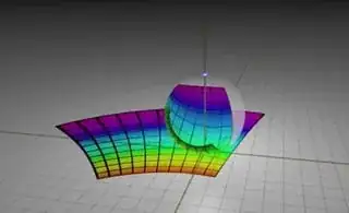

Suppose we have a subset of $\mathbb{C}\cup \{\infty\}$. Then we can project it onto the 2-sphere via the inverse stereographic projection. If we rotate or translate the sphere in the surrounding $\mathbb{R}^3$ and apply the stereographic projection again, then the result amounts to a Möbius transformation of the initial subset. Here is a screenshot to illustrate this:
$\hskip2in$ enter image description here

Now this seems quite interesting to me because it seems to imply that if I take a subset of $\mathbb{R}^2$ and apply a conformal transformation $\Phi$ to it, then I can always write it as \begin{equation} \Phi = P\circ \phi\circ P^{-1} \end{equation} where $P$ is the stereographic projection and $\phi$ is a rotation and/or translation of the sphere in 3-space.
My first question is: Is that right?
