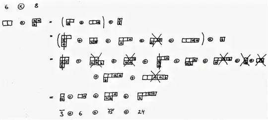

I wrote a Mathematica paclet that can be used to find irreducible representations of $SU(n)$. Specifically, given a product of $SU(n)$ multiplets, it can compute the corresponding sum. To test the paclet, I compare its output with various examples from books. It fails on two occasions, when I compare against Table 4.13.1 on page 83 in The Lie Algebras of su(N) by Walter Pfeifer. I also did the calculations by hand, but I obtain the same answer as my program.
My calculation: $$6 \otimes 8 = \color{red}{\bar{3}} \oplus \bar{15} \oplus 6 \oplus 24$$ Book: $$6 \otimes 8 = \color{red}{3} \oplus \bar{15} \oplus 6 \oplus 24$$
My calculation: $$15 \otimes \bar{15} = 1 \oplus \bar{10} \oplus \color{red}{10} \oplus 8 \oplus 8 \oplus \bar{35} \oplus 27 \oplus 27 \oplus 64 \oplus 35$$ Book: $$15 \otimes \bar{15} = 1 \oplus \bar{10} \oplus \color{red}{\bar{10}} \oplus 8 \oplus 8 \oplus \bar{35} \oplus 27 \oplus 27 \oplus 64 \oplus 35$$
Is this my mistake, or are these typos in the book?
Here is the explicit calculation of the first example, using Young tableaux: enter image description here

    The book is wrong also in the decomposition of $15\otimes \overline{15}$. Surely the decomposition must be its own dual. Meaning that $10$ and $\overline{10}$ must appear with the same multiplicity (both will appear once as per your calculation). – Jyrki Lahtonen Feb 22 '18 at 22:07

The module $V(2\lambda_1)$ has six distinct weights, each with multiplicity one, namely $2\lambda_1, \lambda_2, -2\lambda_1+2\lambda_2, \lambda_1-\lambda_2,-\lambda_1$ and $-2\lambda_2$. Therefore in the tensor product we get summands with highest weights (add $\lambda_1+\lambda_2$ to the weights listed above): $3\lambda_1+\lambda_2$,$\lambda_1+2\lambda_2$, $-\lambda_1+3\lambda_2$, $2\lambda_1$, $\lambda_2$ and $\lambda_1-\lambda_2$. Among these six weights the non-dominant ones have a non-trivial stabilizer under the dot action, so we simply throw those out. The result is that $$ V(2\lambda_1)\otimes V(\lambda_1+\lambda_2)\simeq V(3\lambda_1+\lambda_2)\oplus V(\lambda_1+2\lambda_2)\oplus V(2\lambda_1)\oplus V(\lambda_2). $$ So the same six-dimensional rep $V(2\lambda_1)$ we used as a factor in the tensor product also appears as a summand. The module $V(\lambda_2)$ is the dual of the 3-dimensional module $V(\lambda_1)$, and I'm fairly sure that physicists denote it $\overline{3}$. This is good news in the sense that it says that you're right and your other source is wrong!
Of the other two summands Weyl's dimension formula says that $$ \dim V(3\lambda_1+\lambda_2)=\frac{4\cdot6\cdot2}{1\cdot2\cdot1}=24, $$ and $$ \dim V(\lambda_1+2\lambda_2)=\frac{2\cdot5\cdot3}{1\cdot2\cdot1}=15. $$ The latter module is the dual of $V(2\lambda_1+\lambda_2)$, obviously also 15-dimensional. I may be wrong, but IIRC the way physicists' notation plays out is that of the non-self-dual modules of $SU(3)$ the one whose highest weight $m_1\lambda_1+m_2\lambda_2$ satisfies the inequality $m_1>m_2$ is denoted without the overline, while the other (with highest weight $m_2\lambda_1+m_1\lambda_2$) gets the "bar".
Assuming this recollection is in line with the physicist's notation, we get, in the end $$ 6\otimes 8\simeq 24\oplus6\oplus\overline{15}\oplus\overline{3}. $$

To derive OP's $SU(3)$ fusion rules one can use a Wick-type theorem, explained in my Phys.SE answer here. The Wick-type calculus yields
$$\begin{align} {\bf 6}\otimes {\bf 8} ~=~&(2,0)\otimes (1,1)\cr\cr ~\cong~&:(2,0)\otimes (1,1): ~\oplus~:(\underline{2,0)\otimes (1},1):\cr\cr ~\oplus~&:(\overline{2,0)\otimes (1,1}):~\oplus~:(\overline{\underline{2,0)\otimes (1},1}):\cr\cr ~=~&(3,1)~\oplus~(1,2)~\oplus~(2,0)~\oplus~(0,1)\cr\cr ~=~&{\bf 24}~\oplus~\overline{\bf 15}~\oplus~{\bf 6}~\oplus~\overline{\bf 3}, \end{align} $$
and$^1$
$$\begin{align} {\bf 15}\otimes \overline{\bf 15} ~=~&(2,1)\otimes (1,2)\cr\cr ~\cong~&:(2,1)\otimes (1,2): ~\oplus~:(\underline{2,1)\otimes (1},2): ~\oplus~:(2,\underline{1)\otimes (1,2}): \cr\cr ~\oplus~&:(\overline{2,1)\otimes (1,2}): ~\oplus~:(\overline{\underline{2,1)\otimes (1},2}):~\oplus~:(\overline{2,\underline{1)\otimes (1,2}}):\cr\cr ~\oplus~&:(2,\overline{1)\otimes (1},2): ~\oplus~:(\overline{\overline{2,1)\otimes (1,2}}):\cr\cr ~\oplus~&:(\overline{2,\overline{1)\otimes (1},2}):~\oplus~:(\overline{\overline{2,\overline{1)\otimes (1},2}}):\cr\cr ~=~&(3,3)~\oplus~(1,4)~\oplus~(4,1) ~\oplus~(2,2)~\oplus~(0,3)~\oplus~(3,0)\cr\cr ~\oplus~&(2,2)~\oplus~(1,1)~\oplus~(1,1)~\oplus~(0,0)\cr\cr ~=~&{\bf 64}~\oplus~\overline{\bf 35}~\oplus~{\bf 35}~\oplus~{\bf 27}~\oplus~\overline{\bf 10}~\oplus~{\bf 10}~\oplus~{\bf 27}~\oplus~{\bf 8}~\oplus~{\bf 8}~\oplus~{\bf 1}, \end{align} $$ which confirms OP's calculations.
