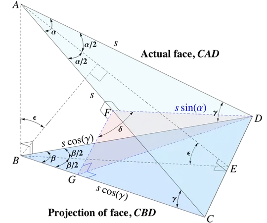

We have isosceles triangle $CAD$ above the plane of triangle $CBD$, making a dihedral angle of $\epsilon$. Triangle $CBD$ is the orthogonal projection of $CAD$, so also isosceles. The apex angle between adjacent edges in triangle $CAD$ is $\alpha$. The angle of triangle $CBD$ is $\beta.$ Edge $AC$ makes a slant angle of $\gamma$ with the projected edge $BC$.
There is a plane perpendicular to slant edge $AC$ through the opposite vertex $D$, which intersects edge $AC$ at point $F$, and $BC$ at point $G$. Angle $GFD$ is $\delta.$
If triangle $CAD$ is the side of a regular pyramid, and $CBD$ its base, then $2\delta$ will be the dihedral angle between adjacent faces, and $\epsilon$ will be the dihedral angle between slant face and base.
I can see that plane $DFG$ is perpendicular to slant edge $AC$, hence why triangles $AFD$ and $AFG$ are right triangles. But why are $DGC$ and $FGD$ right angles?
How do I arrive at $$\sin\delta=\cos(\beta/2)/\cos(\alpha/2)$$?

The short answer is, $DG$ lies in the plane $BCD$ perpendicular to $AB$, and is therefore (parallel to a line) perpendicular to $AB$. $DG$ also lies in the plane $DFG$ perpendicular to $AC$, and therefore is (parallel to a line) perpendicular to $AC$. Being perpendicular to both $AB$ and $AC$, $DG$ is perpendicular to every line in the plane $ABC$ that it intersects, including both $FG$ and $BC$.
Let's walk through the derivation of all three formulas in detail. Following the linked article, we see:
  1. First, from the slant face isosceles triangle $\triangle CAD$, using the right triangle with altitude $AE,$ and $AC=s,$ we have $EC=s\sin(\alpha/2).$
    Altitude $AB$ is perpendicular to plane $CAD,$ so triangle $ABC$ is a right triangle, and we have $BC=AC\cos\gamma=s\cos\gamma.$ From the base isosceles triangle $\triangle CBD$ we have $EC=s\cos\gamma\sin(\beta/2).$
    Equating the two expressions gives $$\cos\gamma = \frac{\sin\left(\frac\alpha2\right)}{\sin\left(\frac\beta2\right)}\tag{1}\label{1}.$$
  2. Next, why are $FG$ and $BC$ (that is, plane $ABC$) perpendicular to $DG$?
    The trick is to realize that the perpendicular to a plane through the vertex of a triangle is orthogonal to all lines in that plane, including the two edges that meet it, as well as (a parallel line to) the opposite edge.
    By construction, plane $DFG$ is perpendicular to $AC$. Therefore $AC$ is perpendicular to any line in $DFG$, ergo $AC$ is perpendicular to $FG$ and $FD$.
    Additionally, line $DG$ lies in plane $BCD,$ so it (or a line parallel to it) is perpendicular to $AB$, as $AB$ is perpendicular to plane $BCD.$ Line $DG$ is also in plane $DFG,$ so perpendicular to $AC$. Therefore it is perpendicular to plane $ABC.$ And therefore also to $FG.$ Angles $\angle DGF$ and $\angle DGC$ are right angles (line $BC$ is also in plane $ABC$ and so perpendicular to $DG$).
    Therefore looking at right triangle $\triangle FGD$ we have $GD=s\sin\alpha\sin\delta.$
    And looking at right triangle $\triangle BGD$ we see $GD=s\cos\gamma\sin\beta.$
    Equating gives $$\sin\delta=\frac{\cos\gamma\sin\beta}{\sin\alpha} \stackrel{\eqref{1}}= \frac{\sin\left(\frac\alpha2\right)\cdot2\sin\left(\frac\beta2\right)\cos\left(\frac\beta2\right)}{\sin\left(\frac\beta2\right)\cdot2\sin\left(\frac\alpha2\right)\cos\left(\frac\alpha2\right)}=\frac{\cos\left(\frac\beta2\right)}{\cos\left(\frac\alpha2\right)}\tag{2}\label{2}.$$
  3. Looking at right triangle $\triangle ABE$ we have $BE=AE\cos\epsilon.$
    From triangle $\triangle AEC$ we have $AE=s\cos\left(\frac\alpha2\right).$
    And from triangle $\triangle BEC$ we have $BE=s\cos\left(\gamma\right)\cos\left(\frac\beta2\right).$
    Thus $$\cos\epsilon=\frac{\sin\left(\frac\alpha2\right)\cos\left(\frac\beta2\right)}{\cos\left(\frac\alpha2\right)\sin\left(\frac\beta2\right)}=\frac{\tan\left(\frac\alpha2\right)}{\tan\left(\frac\beta2\right)}\tag{3}\label{3}.$$
So given the vertex angle $\alpha$ and the projection of that angle into the base $\beta$, we have the edge angle $\gamma$, the dihedral angle $\delta$ between $ABC$ and $ACD$, and the dihedral angle $\epsilon$ between $ACD$ and $BCD$.
Applying this to the regular pyramid, where $CAD$ is a lateral face and $\triangle ABC$ is a vertical (perpendicular to the base) cross section through an edge between adjacent faces, then the dihedral angle between adjacent side faces is $2\delta.$
In terms of the number of sides of the pyramid $n$, since there are $n$ angles of measure $\beta$ around a vertex in the plane, we have $$\beta=\frac{2\pi}{n}.$$ And in terms of the slant edge length $AC=s$, and base side length $CD=\ell$, we have $$\ell=2s\sin\left(\frac\alpha2\right).$$ So in terms of $n,\ell,$ and $s,$ we write $$\begin{align}\cos\gamma&=\frac{\ell}{2s\sin\left(\frac{\pi}{n}\right)},\\\sin\delta&=\frac{2s\cos\left(\frac{\pi}{n}\right)}{\sqrt{4s^2-\ell^2}},\\\cos\epsilon&=\frac{\ell}{\tan\left(\frac{\pi}{n}\right)\sqrt{4s^2-\ell^2}}.\end{align}$$
For example, putting $n=4$, $s=\ell$ gives us the regular square pyramid with $\gamma=\frac{\pi}{4},$ $\sin\delta=\sqrt{\frac{2}{3}},$ and $\cos\epsilon=\frac{1}{\sqrt{3}}.$ Which matches the angles of the regular octahedron in the table of Platonic solid dihedral angles.
Or with $n=3$, $s=\ell$ we get $\cos\gamma=1/\sqrt{3}$ and $\cos(2\delta)=\cos\epsilon=1/3,$ again agreeing with known geometry of the regular tetrahedron.
For a non-Platonic example, a regular hexagonal pyramid with height $h=\sqrt{3}\ell$ and slant edge length $s=2\ell$ will have $\cos(2\delta)=-3/5$, the angle of a $3$-$4$-$5$ triangle.

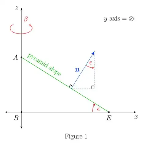

An alternate approach to obtaining the formula for $\delta$ is to take a unit normal $\underline{\mathbf{u}}$ for a given slope and then rotate this by the angle $\beta$ about the $z$-axis, ie about the vector $\underline{\mathbf{k}}$, to produce a unit normal $\underline{\mathbf{v}}$ for the adjacent slope, as shown in Fig. 1. This approach avoids the complication which arises when $\beta > 90^\circ$, for then $G$ is no longer on the line segment $BC$, but extends out to the left beyond $B$ (eg. in the case of the tetrahedron we have $\alpha = 60^\circ$ and $\beta = 120^\circ$, giving dihedral angle $2\delta = \arccos (1/3)$).
Since $\underline{\mathbf{u}}$ and $\underline{\mathbf{v}}$ are both outward pointing, and the dihedral angle between two planes equals the angle between their normals (or its complement), we have : $$ \underline{\mathbf{u}} \cdot \underline{\mathbf{v}} = \cos(180 - 2\delta) = -\cos 2\delta. $$
From Fig. 1 we have : $$ \underline{\mathbf{u}} = \sin \epsilon \; \underline{\mathbf{i}} + \cos \epsilon \; \underline{\mathbf{k}}. $$
Rotating $\underline{\mathbf{u}}$ about the $z$-axis by angle $\beta$ leaves the $\underline{\mathbf{k}}$ component unchanged and changes the component $\sin \epsilon \; \underline{\mathbf{i}}$ to $\sin \epsilon \cos \beta \; \underline{\mathbf{i}} + \sin \epsilon \sin \beta \; \underline{\mathbf{j}}$ so that : $$ \underline{\mathbf{v}} = \sin \epsilon \cos \beta \; \underline{\mathbf{i}} + \sin \epsilon \sin \beta \;\underline{\mathbf{j}} + \cos \epsilon \; \underline{\mathbf{k}} $$
Thus : \begin{eqnarray} 2 \sin^2 \textstyle{\frac{1}{2}} \delta -1 = -\cos 2\delta & = & \underline{\mathbf{u}} \cdot \underline{\mathbf{v}} \nonumber \\ & = & \sin^2 \epsilon \cos \beta + \cos^2 \epsilon \label{eq:Rodrigues} \tag{1} \end{eqnarray}
We require an expression that involves $\alpha$ and $\beta$ only. Denote the altitude of the regular pyramid by $h$, and the radius of its regular polygonal base by $r$. Then : \begin{equation} \sin \epsilon = \frac{h}{s \cos \frac{1}{2} \alpha}, \hspace{1em} \mbox{and} \hspace{1em} \cos \epsilon = \frac{r \cos \frac{1}{2} \beta}{s \cos \frac{1}{2} \alpha} \label{eq:angle-epsilon} \tag{2} \end{equation}
with : \begin{equation} \frac{h}{s} = \sin \gamma \hspace{1em} \mbox{and} \hspace{1em} \frac{r}{s} = \cos \gamma. \label{eq:angle-gamma} \tag{3} \end{equation}
As in the article we can readily establish by computing the length of EC in two ways that : \begin{equation} \cos \gamma = \frac{\sin \frac{1}{2} \alpha}{\sin \frac{1}{2} \beta}. \label{eq:angle-gamma-formula} \tag{4} \end{equation}
Thus putting equations (\ref{eq:Rodrigues}) - (\ref{eq:angle-gamma-formula}) together we now have : \begin{eqnarray*} 2 \sin^2 \textstyle{\frac{1}{2}} \delta -1 & = & \frac{\sin^2 \gamma}{\cos^2 \frac{1}{2} \alpha} \cdot \cos \beta + \cos^2 \gamma \cdot \frac{\cos^2 \frac{1}{2} \beta}{\cos^2 \frac{1}{2} \alpha} \\ & = & \frac{1}{\cos^2 \frac{1}{2} \alpha} \left[ \left( 1 - \frac{\sin^2 \frac{1}{2} \alpha}{\sin^2 \frac{1}{2} \beta} \right) \cdot (\cos^2 \frac{1}{2}\beta - \sin^2 \frac{1}{2}\beta) + \left( \frac{\sin^2 \frac{1}{2} \alpha}{\sin^2 \frac{1}{2} \beta} \right) \cdot \cos^2 \frac{1}{2} \beta \right] \\ & = & \frac{1}{\cos^2 \frac{1}{2} \alpha} \left[ \cos^2 \frac{1}{2} \beta - \sin^2 \frac{1}{2} \beta + \sin^2 \frac{1}{2} \alpha \right] \\ \Rightarrow 2 \sin^2 \delta & = & \frac{1}{\cos^2 \frac{1}{2} \alpha} \left[ \cos^2 \frac{1}{2} \beta - \sin^2 \frac{1}{2} \beta + 1 \right] \\ & = & \frac{2 \cos^2 \frac{1}{2} \beta}{\cos^2 \frac{1}{2} \alpha} \\ \Rightarrow \mbox{since } \alpha, \beta, \gamma \in (0, 180^\circ), \hspace{1.5em} \sin \delta & = & \frac{\cos \frac{1}{2} \beta}{\cos \frac{1}{2} \alpha}. \end{eqnarray*}
