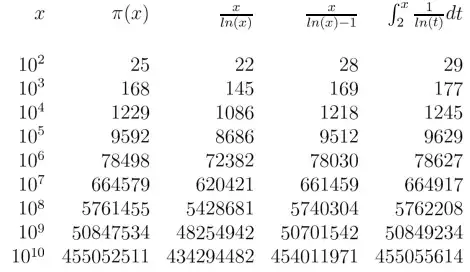

The answers above are very correct and state the Prime Number Theorem. Note that below, $\pi(n)$ means the primes less than or equal to $n$. Pafnuty Chebyshev has shown that if $$\lim_{n \to \infty} {\pi(n) \over {n \over \ln(n)}}$$exists, it is $1$. There are a lot of values that are approximately equal to $\pi(n)$ actually, as shown in the table.
- 7,790
