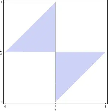

There is also a nice geometric-probability solution to the problem. For simplicity, let $L=1$, with $x$ and $y$ as you describe. The space of all possible values of $x$ and $y$ is the unit square $[0,1]\times[0,1]$, with each point being equally likely (as $x$ and $y$ are uniformly distributed). In order for the three pieces to form a triangle, each piece must have length less than $\frac{1}{2}$, so:
  • if $x<y$: $x<\frac{1}{2}$, $y-x<\frac{1}{2}$, and $1-y<\frac{1}{2}$;
  • or if $x>y$: $y<\frac{1}{2}$, $x-y<\frac{1}{2}$, and $1-x<\frac{1}{2}$.
Graphing these in the unit square gives the shaded region shown below.
graph of inequalities
This region is $\frac{1}{4}$ of the total area of the square, so the probability is $\frac{1}{4}$.
