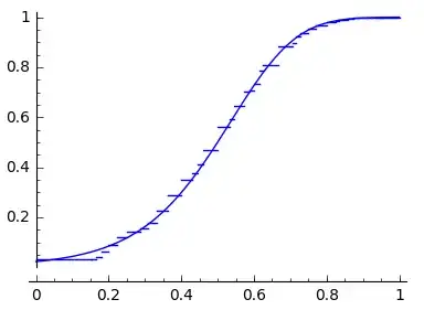

For small $n$ it's feasible to directly compute the exact distribution of $R_n$ combinatorially, which I've done for $n\le 12$. The following plot for $n=12$ shows the exact CDF of $R_{12}$ (the step function), over which I've superposed Hinkley's approximation (the smooth curve):
exact CDF & approximate CDF of R_12
