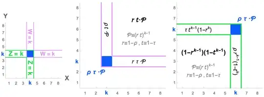

Denote $W \equiv \min(X,Y)$ as the smaller among the two and $Z \equiv \max(X,Y)$ as the larger. The key observation to solve this problem is that $$Z \overset{d}{=} R~, \qquad\qquad \textbf{the maximum has the same distribution as the 'rounds'.}$$ This allows one to think about the whole scenario differently (not as rounds of a two-player game). For all $k \in \mathbb{N}$, since $X \perp Y$ we have \begin{align*} \Pr\{ Z = k \} &= \Pr\{ X < Y = Z = k \} \\ &\hspace{36pt} + \Pr\{ Y < X = Z = k \} \\ &\hspace{72pt} + \Pr\{ X = Y = Z = k \} \\ &= \tau (1 - \tau)^{k-1} (1 - (1-\rho)^k) \\ &\hspace{36pt} + \rho (1 - \rho)^{k-1} (1 - (1-\tau)^k) \\ &\hspace{72pt} + \rho\tau (1 - \rho)^{k-1} (1 - \tau)^{k-1} \tag*{Eq.(9)} \label{Eq09} \end{align*} In principle, now that the distribution of $Z$ (thus $R$) is completely specified, everything one would like to know can be calculated. This is indeed a valid approach (to obtain the mean and variance), and the terms involved are all basic series with good symmetry.

Back to the two-player game scenario, the fact that $W$ is Geometric with success probability $\lambda = 1 - (1 - \rho)(1 - \tau)$ is easy to see: a round 'fails' if and only if both flips 'fail', with a probability $(1 - \rho)(1 - \tau) = 1 - \lambda$.
The contour of $W = k$ is L-shaped boundary of the '2-dim tail', which fits perfectly with the scaling nature (memoryless) of the joint of two independent Geometric distribution. Pleas picture in the figure below that $\Pr\left\{W = k_0 + k ~ \middle|~~ W > k_0 \right\} = \Pr\{ W = k\}$ manifests itself as the L-shape scaling away.
The contour of $Z = k$ looks like $\daleth$, and together with the L-contour of $W$ they make a cross. This is \ref{Eq10} the identity $X+Y = W+Z$, visualized in the figures below. See Appendix.B.1 for the linked in-site posts of related topics.

Derivation of the 2nd moment reveals a more intriguing properties of the setting. \begin{align*} \mathbb{E}[ Z^2 ] &= \mathbb{E}[ (X + Y - W)^2 ] \\ &= \mathbb{E}[ (X + Y)^2 ] + \mathbb{E}[ W^2 ] - 2\mathbb{E}[ (X + Y) W ] \\ &= \mathbb{E}[ X^2 ] + \mathbb{E}[ Y^2 ] + 2 \mathbb{E}[ XY ] + \mathbb{E}[ W^2 ] - 2\mathbb{E}[ (W+Z) W ] \qquad\because X+Y = W+Z\\ &= \mathbb{E}[ X^2 ] + \mathbb{E}[ Y^2 ] - \mathbb{E}[ W^2 ] + 2\mathbb{E}[ XY ] - 2\mathbb{E}[ WZ ] \end{align*} Here's the kicker: when $X \neq Y$, by definition $W$ and $Z$ each take one of them so $WZ = XY$, and when $X = Y$ we have $WZ = XY$ just the same!! Consequently, $\mathbb{E}[ ZW ] = \mathbb{E}[ XY ] =\mu_{_X} \mu_{_Y}$ always, and they cancel. \begin{equation*} \mathbb{E}[ Z^2 ] = \mathbb{E}[ X^2 ] + \mathbb{E}[ Y^2 ] - \mathbb{E}[ W^2 ] = \frac{ 2 - \rho }{ \rho^2 } + \frac{ 2 - \tau }{ \tau^2 } - \frac{ 2 - \lambda }{ \lambda^2 } \tag*{Eq.(8.better)} \label{Eq08better} \end{equation*} This is the proper derivation, and in \ref{Eq08} the 3rd term following $S_X + S_Y$ is indeed $-S_W$.
Keep in mind that both $W$ and $Z$ are clearly correlated with $X$ and $Y$, while our intuition also says that the correlation between $W$ and $Z$ is positive (see Appendix.B for a discussion).
While we're at it, this relation in fact holds true for any (higher) moments, $$\mathbb{E}[ Z^n ] = \mathbb{E}[ X^n ] + \mathbb{E}[ Y^n ] - \mathbb{E}[ W^n ]~.$$This is true due to the same argument that gave us $WZ = XY$, and using \ref{Eq09} doing the explicit sums to derive this identity is also easy.
