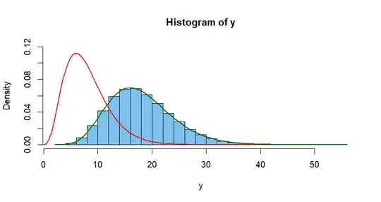

  • @spaceisdarkgreen, I simulated the case $n = 10,, \theta = 0$ to see if this seems to work at all and to confirm your correction of the degrees of freedom. $\mathsf{Chisq}(n-2)$ doesn't fit the histogram of the simulated values, but $\mathsf{Chisq}(2n-2)$ does. Of course, this doesn't prove anything, but (to me anyhow) it offers hope your argument might be made rigorous. – BruceET Nov 29 '17 at 05:39

Comment: @spaceisdarkgreen, I simulated the case $n = 10,\, \theta = 0$ to see if this seems to work at all and to confirm your correction of the degrees of freedom. The red curve is for $\mathsf{Chisq}(n-2)$ and the green for $\mathsf{Chisq}(2n-2).$ Of course, this doesn't prove anything, but (to me anyhow) it offers hope your argument might be made rigorous.
R code in case it is of any use:
m = 10^5;  n = 10
x = rexp(m*n);  MAT = matrix(x, nrow=m)
t = rowSums(MAT);  v = apply(MAT, 1, min)
y = 2*t - 2*n*v
hist(y, prob=T, br= 25, col="skyblue2", ylim=c(0,.12))
 curve(dchisq(x, n-2), 0, 50, lwd=2, col="red", add=T)
 curve(dchisq(x, 2*n-2), lwd=2, col="darkgreen", add=T)
