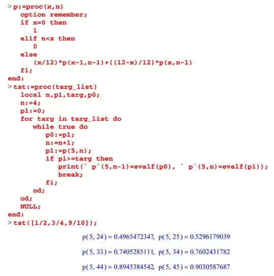

Easiest for me was to set it up as a recursion, and then write a program to implement the recursion.
The following Maple program gets the results you asked about . . .
Thus, based on the results of the program,
  • $25$ rolls are needed for success probability $\ge \frac{1}{2}$.$\\[8pt]$
  • $34$ rolls are needed for success probability $\ge \frac{3}{4}$.$\\[8pt]$
  • $45$ rolls are needed for success probability $\ge \frac{9}{10}$.
