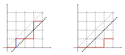

I came up with a visual proof of \begin{equation} Z(m,n, r ) = 2^r \frac{m - n + r}{m + n - r} { m + n - r \choose n- r } \end{equation} that is mush easier than my generating function approach. I think it deserves a separate answer.
The $2^r$ factor
Divide a lattice path of $r$ intersections with the diagonal into $r$ segments where the $i$-th segment is between the $i$-th intersection point and the $i+1$-th.
Each segment is a lattice path that intersects the diagonal only at the end point and there are two possibilities: going above or blow the $ y = x$ line. Hence we can consider only the lattice path below $y = x$ (shown in left figure below). Call the corresponding number of lattice paths to be $Z_{-}( m,n, r )$, we have \begin{equation} Z( m, n, r ) = 2^r Z_{-} ( m, n, r ) \end{equation}
Reduction to $r = 0$
Take a lattice path below the line $ y= x$. At all the intersection points, the preceding step must be going up (labeled blue in the left figure).
If we remove those blue steps, we end up with a path on the right figure that starts from $(0,0)$ and ends at $(m, n - r)$. This path will not hit the diagonal $y = x$. On the other hand, we can also reconstruct the original path by drawing backwards and complementing a blue step when hitting diagonal. For the example in the right figure, we first move the last red step "going right" to the place between $(m-1,n)$ and $(m,n)$. If it hits the diagonal(it does), we complement a blue step; otherwise we pick up the previous red step.
This procedure establish a one-to-one correspondence between the path from $(0,0)$ to $(m,n)$ below $ y= x$ that hits the diagonal $r$ times, with the path from $(0,0)$ to $( m, n-r)$ that does not hit the diagonal at all.
Equivalently, \begin{equation} Z_{-} ( m, n, r ) = Z( m, n -r, 0) \end{equation}
Conclusion
We therefore conclude that \begin{equation} Z(m,n, r ) = 2^r Z(m,n-r, 0) = 2^r \left[ { m + n - r - 1\choose n- r }-{m + n -r -1 \choose n- r - 1 }\right] = 2^r \frac{m - n + r}{m + n - r} { m + n - r \choose n- r } \end{equation}
