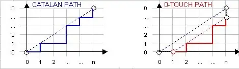

The number of lattice paths, going from $(0,0)$ to $(n,n)$, with steps in ${(1,0),(0,1)}$, and remaining below or touching the diagonal is counted, as you said, by the Catalan Number $$ C(n) = \left( \begin{gathered} 2n \\ n \\ \end{gathered} \right) - \left( \begin{gathered} 2n \\ n + 1 \\ \end{gathered} \right) = \left( \begin{gathered} 2n \\ n \\ \end{gathered} \right) - \left( \begin{gathered} 2n \\ n - 1 \\ \end{gathered} \right) = \frac{1} {{n + 1}}\left( \begin{gathered} 2n \\ n \\ \end{gathered} \right) $$ Catalan
Then, as shown in the sketch, the number of paths that remain below the diagonal without touching it, except at the extremes, is given by $$ N(n,1) = C(n - 1) = \left( \begin{gathered} 2n - 2 \\ n - 1 \\ \end{gathered} \right) - \left( \begin{gathered} 2n - 2 \\ n - 2 \\ \end{gathered} \right) = \frac{{\left[ {1 \leqslant n} \right]}} {n}\left( \begin{gathered} 2n - 2 \\ n - 1 \\ \end{gathered} \right) $$ where the square brackets indicates the Iverson bracket.
Here the number of touches is counted as $1$, corresponding to the number of distinct contact points minus one. So $$ N(n,0) = \left[ {0 = n} \right] $$ Clearly the number of paths below the diagonal, with exactly 1 touch in between, will be the convolution of two "no-intermediate-touch" paths ($m=1$) $$ N(n,2) = \sum\limits_{0\, \leqslant \,k\, \leqslant \,n} {N(k,1)N(n - k,1)} = \sum\limits_{1\, \leqslant \,k\, \leqslant \,n - 1} {\frac{1} {{k\left( {n - k} \right)}}\left( \begin{gathered} 2k - 2 \\ k - 1 \\ \end{gathered} \right)\left( \begin{gathered} 2n - 2k - 2 \\ n - k - 1 \\ \end{gathered} \right)} $$ and so on $$ N(n,m) = \sum\limits_{0\, \leqslant \,k\, \leqslant \,n} {N(k,m - 1)N(n - k,1)} $$ Computing the convolutions as above you obtain for $N(n,m)$ the matrix that corresponds to OEIS sequence A106566 (see also A033184 and A009766 ), whose row sums $=C(n)$ and which corresponds to the final formula given by Brian.
