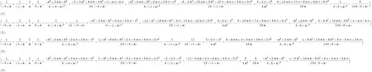

This is an answer to the comment posted by doraemonpaul . The question is to find solutions and possibly outline differences in finding those solutions to the first ODE above. The new ODE reads: \begin{eqnarray} \frac{d^2 v(x)}{d x^2} +\underbrace{\left( \frac{1}{x} + \frac{1}{x-1} + \frac{1}{x+8} \right)}_{a_1(x)} \frac{d v(x)}{d x} - \left( \frac{1}{4 x} - \frac{1}{3(x-1)} + \frac{1}{12(x-4)} + \frac{1}{12(x+8)}\right)v(x)=0 \end{eqnarray} In here we start from the Heun ODE and as usual we change the dependent variable $x\rightarrow f(x)$ and then the independent variable $y(x)=m(x) v(x)$ and then we choose the function $m(x)$ so that the coefficients at the first derivative match. This gives: \begin{equation} m(x)=\sqrt{x(x-1)(x+8)} (1-f(x))^{-d/2} f[x]^{-c/2} \sqrt{f^{'}(x)} (x_0-f(x))^{1/2(-a-b+c+d-1)} \end{equation} and \begin{eqnarray} &&\frac{d^2 v(x)}{d x^2} +\left( \frac{1}{x} + \frac{1}{x-1} + \frac{1}{x+8} \right) \frac{d v(x)}{d x} + \left(\right.\\ &&\left. \frac{f'(x)^2 \left(-a^2-2 a (b-c-d)-b^2+2 b (c+d)-c^2-2 c d-d^2+1\right)}{4 (x_0-f(x))^2}\right.+\\ &&\frac{f'(x)^2 \left(c (a (x_0-1)+b (x_0-1)-2 d x_0+d+x_0-1)+x_0 (a (d-2 b)+d (b-d+1))+c^2 (-(x_0-1))+2 q\right)}{2 (x_0-1) x_0 (x_0-f(x))}+\\ &&\frac{(2-d) d f'(x)^2}{4 (f(x)-1)^2}+\\ &&\frac{f'(x)^2 \left(a (d-2 b)+d (b-c x_0+1)-d^2+2 q\right)}{2 (x_0-1) (f(x)-1)}+\\ &&\frac{f'(x)^2 \left(a (d-2 b)+d (b-c x_0+1)-d^2+2 q\right)}{2 (x_0-1) (f(x)-1)}+\\ &&\frac{f'(x)^2 \left(c (a+b+d x_0-d+1)-c^2-2 q\right)}{2 x_0 f(x)}+\\ &&\frac{1}{4} \left(2 a_1'(x)+a_1(x)^2+\underbrace{\frac{2 f^{(3)}(x) f'(x)-3 f''(x)^2}{f'(x)^2}}_{\mbox{Schwarzian derivative}}\right)\\ &&\left.\right)v(x)=0 \end{eqnarray} Now we take the good old Moebius function $f(x)=(A x+B)/(C x+D)$ (note that this anihilates the Schwarzian derivative in the last term in parentheses above) and we choose the upper case constants in the usual way i.e. via \begin{eqnarray} \left( \begin{array}{r} \frac{B}{A}\\ \frac{B-D}{A-C} \\ \frac{D}{C} \\ \frac{B-Dx_0}{A-Cx_0} \end{array}\right) = \left( \begin{array}{r} 0\\ -1 \\ -4 \\ 8\end{array}\right) \odot \pi \end{eqnarray} where $\pi$ is a permutation of length four. Having done this we decompose into partial fractions the coefficient at the zeroth derivative and then we anihilate the terms being proportional to second powers. This gives us four equations with five unknowns so we expect to get one free parameter. This is indeed the case. One of the twenty four cases reads: \begin{eqnarray} \frac{d^2 v(x)}{d x^2} +\left( \frac{1}{x} + \frac{1}{x-1} + \frac{1}{x+8} \right) \frac{d v(x)}{d x} + \left(\frac{11-24 q}{18 (x-1)}+\frac{6 q-\frac{3}{2}}{24 (x-4)}+\frac{18 q-8}{16 x}+\frac{-6 q-7}{144 (x+8)}\right) v(x)=0 \end{eqnarray} where \begin{eqnarray} v(x)=\frac{1}{m(x)} \left( C_1 \cdot Hn\left( \begin{array}{r|rr|} x_0 & a & b \\ q & c & d \end{array} f(x) \right) + C_2 \cdot [f(x)]^{1-c} Hn\left( \begin{array}{r|rr|} x_0 & a+1-c & b+1-c \\ q_1 & 2-c & d \end{array} f(x) \right) \right) \end{eqnarray} where $q_1=q-(c-1)(a+b-c-d+d x_0 +1)$ and $(a,b,c,d,q)=(1/2,1/2,1,0,q)$ and $x_0=2/3$ and $f(x)=(3 x)/(4(x-1))$.
A =.; B =.; CC =.; DD =.; x0 =.;
a =.; b =.; c =.; d =.; q =.;
A1[x_] = 1/x + 1/(x - 1) + 1/(x + 8);
perm = Permutations[{1, 2, 3, 4}];
sol = Table[{A, B, CC, DD, x0} /.
    Solve[{B/A,
       DD/CC, (B - DD)/(A - CC), (B - DD x0)/(A -
          CC x0)} == {0, -1, -4, 8}[[perm[[j]]]]], {j, 1, 24}];
MatrixForm[sol]; myList = {};
Do[
 {A, B, CC, DD, x0} = First[sol[[which]]];
 f[x_] = Simplify[(A x + B)/(CC x + DD)];
 m[x_] = Sqrt[x (x - 1) (x + 8)] (1 - f[x])^(-d/2) f[x]^(-c/2) Sqrt[
    f'[x]] (x0 - f[x])^(1/2 (-a - b + d + c - 1));
 A0[x_] =
  Apart[Together[-(-1 + a^2 + b^2 + c^2 + 2 a (b - c - d) + 2 c d +
         d^2 - 2 b (c + d))  (Derivative[1][f][x]^2)/(
      4 (x0 - f[x])^2) + (2 q -
        c^2 (-1 + x0) + ((1 + b - d) d + a (-2 b + d)) x0 +
        c (-1 + d + a (-1 + x0) + b (-1 + x0) + x0 - 2 d x0))  (
      2 (-1 + x0) x0 (x0 - f[x])) - (-2 + d) d Derivative[1][f][x]^2/(
      4 (-1 + f[x])^2) + (-d^2 + a (-2 b + d) + 2 q +
        d (1 + b - c x0))  (Derivative[1][f][x]^2)/(
      2 (-1 + x0) (-1 + f[x])) - (-2 + c) c  (Derivative[1][f][x]^2)/(
      4 f[x]^2) + (-c^2 - 2 q + c (1 + a + b - d + d x0))  (
      Derivative[1][f][x]^2)/(2 x0 f[x]) +
     1/4 (A1[x]^2 +
        2 Derivative[1][A1][x] + (-3 (f^\[Prime]\[Prime])[x]^2 +
         2 Derivative[1][f][x]
\!\(\*SuperscriptBox[\(f\),
TagBox[
RowBox[{"(", "3", ")"}],
Derivative],
MultilineFunction->None]\)[x])/Derivative[1][f][x]^2)], x];
 eX = A0[x];
 subst = {a, b, c, d} /.
   Solve[{Coefficient[eX, x, -2], Coefficient[eX, 1/(x - 1)^2],
      Coefficient[eX, 1/(x - 4)^2],
      Coefficient[eX, 1/(x + 8)^2]} == {0, 0, 0, 0}];
 {a, b, c, d} = subst[[1]];
 Clear[v]; Clear[y];
 myeqn = (D[
     y[x], {x,
      2}] + (c/x + d/(x - 1) + (a + b - c - d + 1)/(x - x0)) D[y[x],
      x] + (a b x - q)/(x (x - 1) (x - x0)) y[x]);
    subst = {x :> f[x],
   Derivative[1][y][x] :> 1/f'[x] Derivative[1][y][x],
   Derivative[2][y][x] :> -f''[x]/(f'[x])^3 Derivative[1][y][x] +
     1/(f'[x])^2 Derivative[2][y][x]};
    myeqn =
  Collect[(myeqn /. subst /. y[f[x]] :> y[x]), {y[x], y'[x], y''[x]},
   Simplify];
    y[x_] = m[x] v[x];
 eX = FullSimplify[
   myeqn /. Derivative[2][v][x] :> -A1[x] v'[x] - A0[x] v[x]];
 myList = Join[myList, {{f[x], x0}}];
 Print[{eX, A0[x], {a, b, c, d, q}, x0, f[x]}];
 , {which, 1, 24}]
To summarize this ODE is indeed different from the first one on top of this webpage in that in here we obtained twenty four different exactly solvable cases whereas in the other case all the twenty four cases turn out to be the same.
