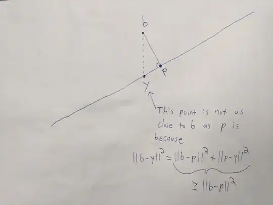

Let $V$ be a subspace of $\mathbb R^n$ and let $b \in \mathbb R^n$ be a point that does not belong to $V$. Decompose $b$ as $b = b_1 + b_2$ where $b_1 \in V$ and $b_2 \in V^\perp$. I claim that $b_1$ is the point in $V$ which is closest to $b$. Proof: If $y$ is any other point of $V$, then $b - y = b - b_1 + b_1 - y$. (Visualize this.) Because the vector $b - b_1$ is orthogonal to $b_1 -y$, the Pythagorean theorem implies that $$\|b - y \|^2 = \| b - b_1 \|^2 + \| b_1 - y \|^2 \geq \|b - b_1 \|^2.$$ This shows that $b_1$ is closer to $b$ than $y$.
In a least squares problem, we are given a matrix $A$ and a vector $b$ which does not belong to the range of $A$ (so $Ax = b$ has no solution), and we want to find the closest vector to $b$ in the range of $A$. Let $\hat b$ be the closest point to $b$ in the range of $A$. Note that $\hat b = Ax$ for some $x$. By the above discussion, the vector $b - Ax$ is orthogonal to the range of $A$. In particular, $b - Ax$ is orthogonal to each column of $A$. A concise way to state this fact is $$ A^T(Ax - b) = 0. $$ This system of equations is called the "normal equations" and by solving it we find the vector $x$ such that $\hat b = Ax$ is as close as possible to $b$.
Edit: Here's a picture I drew that gives a simpler explanation.enter image description here

    @CharlieParker You're right, I was proving something a little more general than what you asked about. I drew a picture that might answer your question more directly. We could avoid mentioning vectors entirely by saying $d(b,y)^2 = d(b,p)^2 + d(p,y)^2$. – littleO Jul 17 '17 at 22:47
  • wow thats was super intuitive! I liked it a lot. Appreciate your addition of the picture. But now that I reflect on it, it seems that its due to the triangle inequality, no? I can't see how orthogonality is explicitly connected without known apriori pythagoras theorem. – Charlie Parker Jul 19 '17 at 05:43
