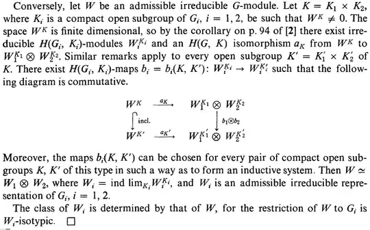

The problem: let $G_1, G_2$ be groups of td-type, and let $G = G_1 \times G_2$. The Hecke algebra of $G$ can be identified with $H(G_1) \otimes H(G_2)$. I'm trying to understand why every irreducible admissible representation $(\pi,V)$ of $G$ decomposes as a tensor product of irreducible admissible representations $V_1 \otimes V_2$ for $G_1$ and $G_2$. My reference is the article Decomposition of Representations into Tensor Products by D. Flath:
The reference [2] is a result in Bourbaki, Algebra, Chap VIII, which says that if $A, B$ are unital algebras over an algebraically closed field $k$, and $P$ is a simple unitary $A \otimes_k B$-module, then $P$ is isomorphic to $M \otimes_k N$ for simple modules $M, N$ over $A, B$.
What I'm confused on is where the maps $b_1, b_2$ are coming from, why they can be chosen to be injections, and why they can be chosen to form a directed system over the fundamental system of open compact neighborhoods $K_1 \times K_2$ of $G_1 \times G_2$. I would appreciate any reference or a hint.
