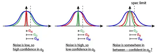

I'm measuring a characteristic of a device that has a normal distribution ($0$ mean and std dev of $\sigma_M$).
There is, however, noise in the measurement process, which also has a normal distribution ($0$ mean and std dev of $\sigma_N$). I can measure this noise independently.
I can estimate the device's true characteristic (without noise) as $\sigma_D = \sqrt{\sigma_M^2 - \sigma_N^2}$. To be compliant with a specific spec, $\sigma_D$ must be less than $L$.
If the noise is small compared to the measured value, I have high confidence in my data. But my confidence drops as the noise approaches the measured value. In the extreme case, if $\sigma_M = \sigma_N$, my estimation returns $\sigma_D = 0$, indicating that I've reached the noise floor of my equipment (I think that's the correct interpretation, but let me know if not).
confidence in data, scenarios
My question is, how close can $\sigma_N$ be to $\sigma_M$ such that $\sigma_D$ is still "accurate"?
I don't want to report a value of $\sigma_D$ that contains too much error. Rather, I'd like to report some lower bound for $\sigma_D$ once $\sigma_N$ becomes too close to $\sigma_M$. Any light you can shed to help me define that lower bound would be much appreciated.
UPDATE 1
  • To clarify, I measure $(1)$ the device with noise and, separately at a later time, $(2)$ the noise (without the device).
  • The distribution of noise measured directly (without the device) can be assumed to also exist when the device is measured with noise, and that it is the ONLY noise present when the device is measured with noise.
UPDATE 2
Is the following statistically meaningful as a condition where $\sigma_D$ is inaccurate: $$ \sigma_M - \sigma_N < \dfrac{1.96}{\sqrt{n}}(\sigma_M + \sigma_N) \;, $$ where $n$ is the number of samples used to compute the sigmas?

  • Are you saying you can measure what the contribution of the noise was in a given measurement of the device, or that you can only separately measure the device with noise and the noise? The former problem is very easy, the latter problem seems subtle. – Ian Jul 01 '17 at 15:40
  • It's an issue of when the measurements happen. You can measure the noise, but presumably you can't measure the actual contribution of the noise at the same time as you measure the device. Instead you can measure the distribution of the noise but not how it actually contributed to your device experiments. Is that correct? Again I ask because the other interpretation is a trivial problem (since you can simply subtract off the noise measurements). – Ian Jul 01 '17 at 15:54
  • In symbols, I'm asking whether you have ${ X_i }{i=1}^n$ and ${ X_i + Y_i }{i=1}^n$ vs. ${ X_i }{i=1}^n$ and ${ X_i + Y_i }{i=n+1}^{2n}$, where $X$ is the noise and $Y$ is the signal. I think you have the second one. – Ian Jul 01 '17 at 15:59
  • The second one. See update 1 above. – user46688 Jul 01 '17 at 16:27
  • What you can really find is actually a probability and a confidence interval. The notation in Update 2 should be changed, as you do not know the true values of the variances, but only their estimates. Please, denote estimated values with a hat, e.g. $\hat{\sigma}_D$. The bound you are looking for is the Cramer-Rao Lower Bound. If you knew the true value of $\sigma_D$, the problem would be much, much easier. But you don't and you have to take that into account. – PseudoRandom Jul 02 '17 at 09:02
  • Imagine you know the true value of $\sigma_M$. Your original problem says to establish if $X < L$, where $X \sim \mathcal{N}(0, \sigma^2_M)$. But since $X$ is random variable, we can only calculate the probability $\mathbb{P}(X < L)$. Now, if $Z$ is standard normal, $X = \sigma_M Z$, so $\mathbb{P}(X < L) = \Phi(\frac{L}{\sigma_M})$ and the problem is over. In that case, you can say ''with a probability of N%, the device is compliant''. But true $\sigma_M$ is unknown, so everything gets complicated. Are you with me up to this point? – PseudoRandom Jul 02 '17 at 18:32
  • I edited the original posting to clarify that the original problem is to determine with some confidence that the true value of $\sigma_D$ is < $L$. Other than that, I think I'm with you. – user46688 Jul 02 '17 at 23:48
  • Ok, it's a bit different now. If $\sigma_D$ was known, there would be no problem at all. For unknown $\sigma_D$, we actually want to evaluate $\mathbb{P}(\hat{\sigma}_D < L)$, where $\hat{\sigma}_D$ is an estimate of $\sigma_D$. So we only need to know the CDF of $\hat{\sigma}_D$. Now, to do that, I need you to tell me which formula you are using to estimate all the $\sigma$s, because there are several options available (some formulas are biased, others are unbiased). – PseudoRandom Jul 03 '17 at 07:05
  • Thanks @PseudoRandom, I measure n samples, compute their mean, subtract this mean from each sample, then compute $\sigma_M$ and $\sigma_N$ using $\sigma=\sqrt{ \frac{1}{n} \sum_1^nx_i^2}$. – user46688 Jul 03 '17 at 14:33
  • So the formula actually is: $\hat{\sigma} = \sqrt{\frac{1}{n}\sum_{i=1}^n (x_i - \bar{x})^2}$, where $\bar{x}$ is the sample mean. – PseudoRandom Jul 05 '17 at 07:51
  • Yes, that's how I compute $\sigma$. – user46688 Jul 05 '17 at 13:51
  • But you can compute only $\sigma_N$ that way, since you have noise-only data. Let $z_i = x_i + w_i$ denote signal+noise data ($w_i$ is noise, $x_i$ is device, $z_i$ measures). If you try to use that formula, you get an estimate of $\sigma_M + \sigma_N$, since $\rm \sigma^2_z = Var[z_i] = Var[x_i] + Var[w_i] = \sigma^2_M + \sigma^2_N$. So, how do you compute $\hat{\sigma}_M$ ? Do you subtract $\sigma^2_N$ ? I suspect that what you are calling $\sigma_D$ is just $\hat{\sigma}_M$ and that you did a notational abuse with $\sigma_M$ meaning $\hat{\sigma}_z$ – PseudoRandom Jul 05 '17 at 15:05
  • This would make sense if I read D = Device, M = Measures, N = Noise. Which would imply that the device is $X \sim \mathcal{N}(0, \sigma^2_D)$, while noise is $W \sim \mathcal{N}(0, \sigma^2_N)$ and measures, $z_i = x_i + w_i$, are actually $Z \sim \mathcal{N}(0, \sigma^2_M)$. This would also make sense since the spec limit regards the device, that's why you have $\sigma_D < L$. – PseudoRandom Jul 05 '17 at 15:11
  • Thanks @PseudoRandom. I compute (perhaps incorrectly?) $\hat{\sigma_M}$ using the above std dev formula using $z_i$, because I measure $z_i$ with a population of $n$. So I just insert all those $z_i$ values to compute its std dev. The measurable quantities are $z_i$ and $w_i$, and I need to extract from them $\hat{\sigma_D}$. Could you clarify where I've gone wrong? Is it the way I've defined the problem, or how I attempted to solve it? Thanks – user46688 Jul 05 '17 at 16:46
  • It is just a notational problem in the question, don't worry too much about it. Check my full answer for the detail regarding the sample mean, but observe that for $n \rightarrow +\infty$, there is no difference since $\bar{x} \rightarrow \mu$, where $\mu$ is the true value of the mean, which is zero in our case. – PseudoRandom Jul 05 '17 at 18:41
