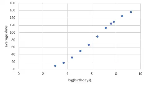

I have repeated this test for a range of number of birthdays up to 10000. I graphed how many days are required to cover at least half of all birthdays (Note the logarithmic scale).
For a small number of birthdays the average number of days required is pretty much half of the number of birthdays.
For "medium" number of birthdays it appears that there is relationship like $\text{[Average Days Required]} = a + b\log(\text{[Number Birthdays]})$
However, this relationship can't hold for larger numbers of birthdays because the average days required can't go above 183.
I don't show the variances in the graph but one interesting observation is that the variance peaks at around 183 birthdays

  • Thank you!! i'll try and play with the coded myself for a bit. So how often would you say that the number is between 120 and 130? – Bram28 Jun 30 '17 at 01:03
  • @Bram28 The mean is 124.8 and the variance is 5 days. If you assume the number of days has a normal distribution then 97% of the time the number of days required is in the range 120-130 – Hugh Jun 30 '17 at 07:23
  • Aha! So I was a good bit off with my guess on $X$, but my guess on $Y$ was pretty good :). Thanks a lot for your help! – Bram28 Jun 30 '17 at 09:30
