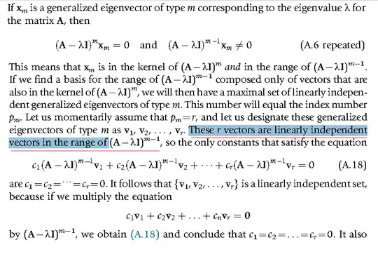

Old question/Optional Background info that can be skipped: This is from Bronson et al Linear Algebra p. 396 explaining the Jordan Canonical Form. Aside from lots of typos from copying and pasting latex in the examples of this third edition text, the explanation of Jordan Canonical Form from this book finally makes the concept make sense to me excluding one part: Why are the generalized eigenvectors of type m linearly independent from each other? At first I thought the authors were using the fact that regular eigenvectors of different eigenvalues are linearly independent, but then I remembered that isn't true for eigenvectors used to form the jordan canonical form, the allowance of repeat eigenvalues of any (not just hermitian) matrices being the point. Here is the text quoted:
Please note, I understand why the eigenvectors from the same chain are linearly independent, and invariant with each other. My question is why are the eigenvectors of type m at one level of separate chains linearly independent from each other, as they can and are propagated from the same repeated eigenvalue sometimes and therefore the equation using the eigenvectors of type m converted to regular eigenvectors doesn't prove that they independent by the same reasoning as eigenvectors of distinct eigenvalues.
