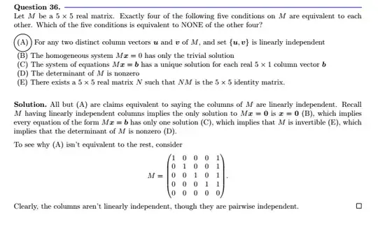

Here is a question in GRE subject exam 0568 with its solution, I want to understand why the author said in the solution that "Recall

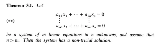

M having linearly independent columns implies the only solution to Mx = 0 is x = 0", could anyone explain this for me, is there a theorem that said this? if so could anyone tell me a book that contains this theorem with its proof ? as I am confused with the theorem given in the following picture
, thanks in advance.

3Any book in linear algebra. Try Lang's – Francesco Polizzi Jun 21 '17 at 10:12
1What theorems? The solution gives outlines of proofs for the statements. If it is a reference you want, you can choose any Linear Algebra book. – Bobson Dugnutt Jun 21 '17 at 10:14
@FrancescoPolizzi could u please tell me exactly the name of the book and its author? thanks in advance. – Jun 21 '17 at 10:44
1Serge Lang, Linear Algebra – Francesco Polizzi Jun 21 '17 at 11:20

Write $M = (v_1,\dots,v_n)$ in terms of its columns. Then $M(x_1,\dots,x_n)^T = x_1v_1 + \dots + x_nv_n$. Saying $Mx$ has no non-zero solution is exactly saying that $v_1,\dots,v_n$ are linearly independent.
If $Mx = Mx'$ and $x \ne x'$ then $M(x - x') = 0$ and $x - x' \ne 0$.
If $Mx = 0$ has no non-zero solutions then $\ker M = \{0\}$ so $\operatorname{im} M = 5$ by Rank-Nullity. Thus $M$ is injective and surjective and hence invertible.
If $M$ is invertible then $\det M \det M^{-1} = \det I = 1$ so $\det M \ne 0$.
