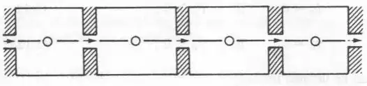

Upwind Schemes
MSE reference:
The following is from the famous book by S.V. Patankar: Numerical Heat Transfer and Fluid Flow; Hemisphere Publishing Company U.S.A. 1980 (page 84).
The scheme is sometimes said to be based on the "tank-and-tube" model (Gosman, Pun, Runchal, Spalding, and Wolfshtein, 1969). As shown in Fig. 5.2 [below], the control volumes can be thought to be stirred tanks that are connected in series by short tubes. The flow through the tubes represents convection, while the conduction through the tank walls represents diffusion. Since the tanks are stirred, each contains a uniform temperature fluid. Then, it is appropriate to suppose that the fluid flowing in each connecting tube has the temperature that prevails in the tank on the upstream side. Normally, the fluid in the tube would not know anything about the tank toward which it is heading, but would carry the full legacy of the tank from which it has come. This is the essence of the upwind scheme.
Especially take notice of the phrase: the fluid in the tube would not know anything about the tank toward which it is heading, but would carry the full legacy of the tank from which it has come. With other words, the upwind scheme is equipped with "knowledge" about past and future. In the continuous analogue, on the contrary, the so-called arrow of time is completely absent. Thus, when taking the limit for tank and tube sizes to zero, directional information is lost forever. Therefore in the upwind case, the Continuous, instead of the better and the more exact, rather seems to be sort of sloppyfication of the Discrete.
It is demonstrated in the same MSE reference that upwind schemes are no way less accurate than, for example, central differences. It's even possible to reproduce "exact" (read: analytical) solutions with them. So the argument that upwind schemes are only $O(h)$ instead of $O(h^2)$ is just ge-$O(h)$, as we would say it in good old Dutch :-)

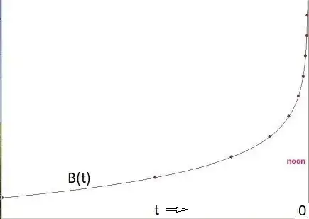

The following question is copied from an old thread in sci.math
Suppose you have a giant vase and a bunch of ping pong balls with an
integer written on each one, e.g. just like the lottery, so the balls
are numbered 1, 2, 3, ... and so on. At one minute to noon you put
balls 1 to 10 in the vase and take out number 1. At half a minute to
noon you put balls 11 - 20 in the vase and take out number 2. At one
quarter minute to noon you put balls 21 - 30 in the vase and take out
number 3. Continue in this fashion. Obviously this is physically
impossible, but you get the idea. Now the question is this: At noon,
how many ping pong balls are in the vase?
The answer given by most mathematicians sounds as follows:
Every ball placed into the vase (at a well-defined time before noon) is taken out from the vase (at a later, well-defined time before noon). Therefore at noon the vase is empty, there are no balls in the vase at noon.
However, we can say that the number of balls $\;B_k\;$ at step $\;k=1,2,3,4,\cdots\;$ is: $$ B_k=B(t_k) = 9 +\, ^2\log(-1/t_k) \quad \mbox{where} \quad t_k = -1/2^{k-1} $$ And if we properly interpolate these values, then we have a continuous function that does not have the following limit: $$ \lim_{t\to 0} B(t) = \lim_{t\to 0} \left[ 9 +\, ^2\log(-1/t) \right] = 0 $$ So (according to standard mathematics) the discrete is not isomorphic to the continuous at noon.
