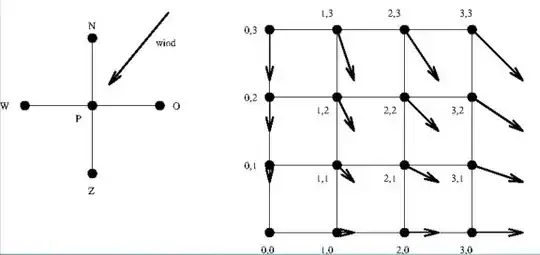

BONUS. As a second example, consider a 2-D case : pure convection of heat . The OP's unknown function $\phi$ is identified with $T$ (temperature) in concordance with this. $$ a(x,y)\phi_x+b(x,y)\phi_{xx}+c(x,y)\phi_{y}+d(x,y)\phi_{yy}=f(x,y) \\ b(x,y)=d(x,y)=f(x,y)=0 \quad ; \quad a(x,y)=u(x,y) \quad ; \quad c(x,y) = v(x,y) \\ \Longrightarrow \quad u(x,y)\frac{\partial T}{\partial x} + v(x,y)\frac{\partial T}{\partial y} = 0 $$ Let the flow field be defined analytically by : $\;u(x,y) = x \; , \; v(x,y) = -y$ .
The discretization of the velocity field is: $$ u = i \qquad ; \qquad v = - j $$ The upwind scheme at a five point star is: $$ U.(T_O-T_P) + V.(T_N-T_P) = 0 $$ In our case - look at the wind - it is seen that $U = u$ and $V = -v$ . Working out the upwind scheme for the temperatures therefore results in: $$ (i+j).T_{i,j} = i.T_{i-1,j} + j.T_{i,j+1} $$ Assume a linear temperature profile on top, where the fluid comes in: $T_{i,3} = i$. The walls are always streamlines, hence $T_{0,j} = T_{i,0} = 0$. Now the temperatures in the rest of the field can be calculated by hand, for example: $$ (1+2).T_{1,2} = 1.0 + 2.1 = 2 \quad \Longrightarrow \quad T_{1,2} = 2/3 $$ After six of these simple calculations the temperature field reads as follows:
        0     1     2     3
        0    2/3   4/3    2
        0    1/3   2/3    1
        0     0     0     0
Take a look at the temperature profile at the outflow opening: it is exactly as expected!
Even better. It can be proved that the discrete temperature field for an $N\times N$ grid is given in general by: $T_{i,j} = i.j/N$ . Which corresponds exactly with the analytic solution: $T(x,y) = x.y$ .
