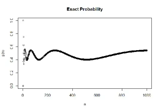

The following shows the graph of $p(n)$ from $n=1$ to $1000$:
The local maxima and minima appear approximately at powers of $2$ (sometimes shifted by $1$). The maxima are at powers of $2$ which are also powers of $4$ and the minima at the other powers of $2$ (hence of the form $2 \cdot 4^k$). This is somewhat intuitive given that the expected number of survisors in a single round is $\frac{n}{4}$. Furthermore, this expected value is also the most likely value (in the case that $n$ is a multiple of $4$). For example if you start with $128$, the first round could be expected to get you to $32$, the next round to $8$, from thence to $2$, which prompty peck each other, leaving you with $0$. This is a hueristic way of reasoning that becomes somewhat less plausible with each factor of $4$.

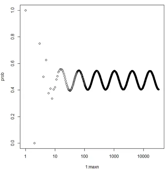

You seem to have used R for your graphs, so here is my attempt:
c2a <- function(n,k){ exp( lchoose(n,2*k)-(n-1)*log(2) )}
c2b <- function(n,k){ (-1)^k * exp( lchoose(n/2,k)-(n-1)*log(2) )}
maxn <- 2^15
prob <- 1
for (n in 2:maxn){
  if (n %% 2 == 0){
    prob [n] <- sum( (c2a(n,1:(n/2)) + c2b(n,1:(n/2))) *
                prob[1:(n/2)] )
    }else{
    prob [n] <- sum( (c2a(n,1:((n-1)/2))) *
                prob[1:((n-1)/2)] )
A graph with a log scale looks like
plot(1:maxn, prob, log="x")
pecking probabailities
and looking at the values at powers of $2$ suggests that the peaks and troughs may have separate limits
> prob[4^(1:7)]
[1] 0.5000000 0.5571170 0.5468982 0.5442833 0.5436387 0.5434781 0.5434380
> prob[2*4^(1:7)]
[1] 0.3359375 0.3950479 0.4016141 0.4031632 0.4035449 0.4036400 0.4036638

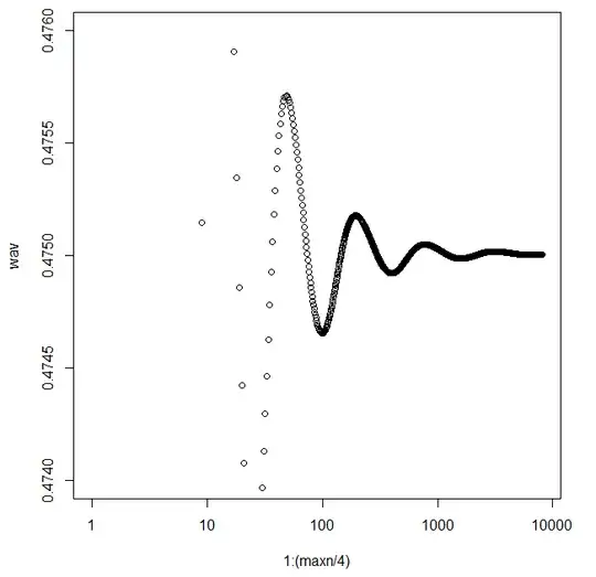

while taking a weighted average of the probabilities across a cycle from $m$ through to $4m-1$ suggests a central figure something like $0.475$, which is marginally more than the average of the apparent limits for powers of $2$
wav <- numeric()
for (m in 1:(maxn/4)){
  wav[m] <- sum(prob[m:(4*m-1)]/(m:(4*m-1))) / sum(1/(m:(4*m-1)))
plot(1:(maxn/4), wav, log="x", ylim=c(0.474, 0.476))
pecking probability weighted average
