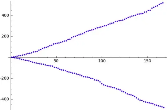

I am interested in the following sum:
$$S_n:=\sum_{k=1}^n (-1)^kp_k$$
Since the sequence $(S_n)$ is related to the gaps between prime numbers, I would expect it to be quite irregular.

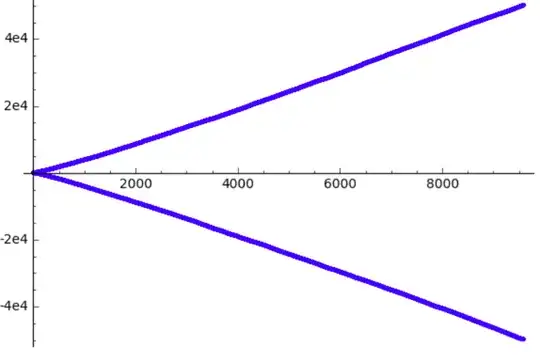

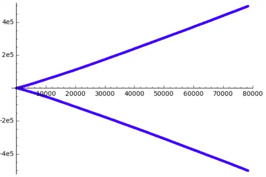

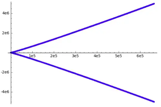

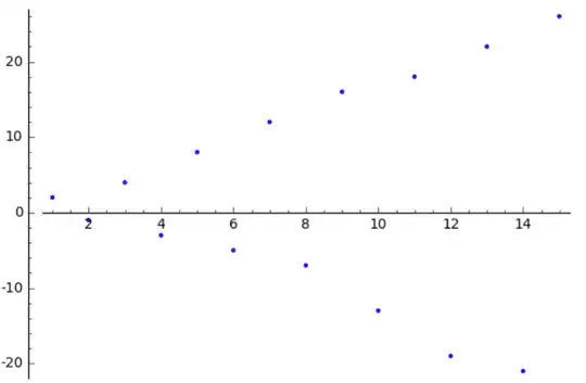

But if we plot $(S_n)_{1\leqslant n\leqslant N}$ for $N\in \{50,10^3,10^5,10^6,10^7\}$, we obtain the following:
We can observe a great regularity.
So my questions are:
  • Why is there so much regularity?
  • Can we find the equations of the two lines forming $(S_n)$?
  • Is there a proof that it will continue to be that regular forever?
Any contribution, even partial, will be greatly appreciated.

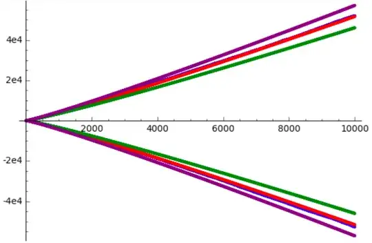

Updates.

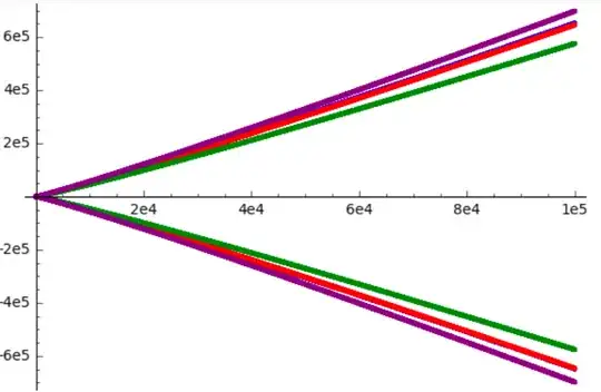

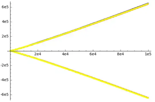

Thanks to mixedmath and Daniel Fischer, here is more curves:
  • in blue, you have $S_n$;
  • in red, you have $\displaystyle 2^{1/6}\displaystyle \sum (-1)^k k\log k$;
  • in green, you have $\displaystyle \sum (-1)^k k\log k$;
  • in purple, you have $\displaystyle \sum (-1)^k k(\log k+\log\log k)$;
  • in yellow, you have $\displaystyle \sum (-1)^k k(\log k+\log\log k-1)$.
My question seems quite related to this one.

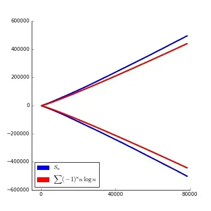

This is a great question. Unfortunately, this is an incomplete answer. But I thought about this a bit and I noticed something interesting, but which I do not know how to explain.
With $$ S_n = \sum_{k \leq n} (-1)^k p_k,$$ where $p_n$ is the $n$th prime, some patterns are immediately clear. It is obvious that the sequence of $S_n$ alternates in sign for example. But some patterns are not obvious or clear.
By the prime number theorem, we expect that $p_n \approx n \log n$. If we plot $\sum_{k \leq n} (-1)^k k \log k$ against $S_n$ for all primes up to one million, we get
A pretty good, but not great, plot
This is apparently a bit too small, it seems. This sort of makes sense, as deviations from the approximation $p_n \approx n \log n$ compound here.

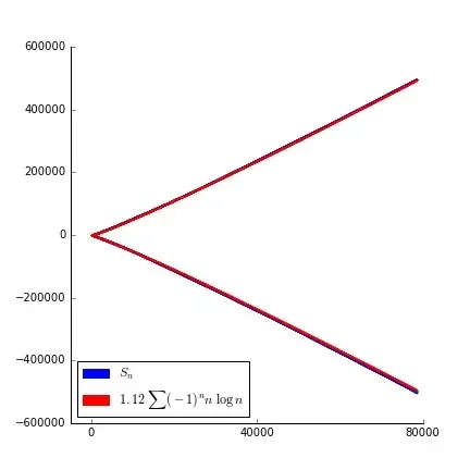

However, I noticed that $$ 1.12 \sum_{k \leq n} (-1)^k k \log k $$ is actually a very good (experimental) estimate of what's going on, as can be seen in the following plot.
A better fit
Perhaps $1.12$ is an incorrect choice --- it just happened to be a very nearby reasonable seeming number, and it does appear to reflect what's going on. I do not know why, though.
If we conjecture for a moment that $1.12 \sum (-1)^k k \log k$ is a good estimator, then we can write a good asymptotic for this series using partial summation. Namely
$$ \begin{align} \sum_{k \leq n} (-1)^k k \log k &= \left( \sum_{k \leq n} (-1)^k k \right) \log n - \int_1^n \left( \sum_{k \leq t} (-1)^k k \right) \frac{1}{t} dt \\ &= (-1)^n \left \lfloor \frac{n+1}{2} \right \rfloor \log n - \int_1^n (-1)^{\lfloor t \rfloor} \left \lfloor \frac{\lfloor t \rfloor+1}{2} \right \rfloor \frac{1}{t} dt \\ &= (-1)^n \left \lfloor \frac{n+1}{2} \right \rfloor \log n + O \left( \int_1^n \left( \frac{t+1}{2t} + \frac{2}{t} \right) dt\right) \\ &= (-1)^n \left \lfloor \frac{n+1}{2} \right \rfloor \log n + O(n). \end{align}$$
So I conjecture that $$S_n \approx 1.12 (-1)^n \left \lfloor \frac{n+1}{2} \right \rfloor \log n + O(n).$$ For comparison, the size of the alternating sum of the first 1001 primes is $3806$, where this estimate gives about $3876.6$. For $10001$, the actual is $52726$, compared to the estimated $51588.7$. These are both close, although apparently not super accurate.
It may be possible to describe the actual behavior of $S_n$ a bit more by using secondary terms in the prime number theorem, but I was not successful in my back-of-the-envelope computations. Nor do I know how to explain the $1.12$ that appears in this answer (or how to determine if it is $1.12$ as opposed to, say, $1.15$). Perhaps someone else will see how to fill in these gaps.

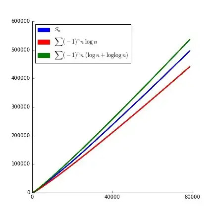

Here are updated images, including plots of $\sum (-1)^n n (\log n + \log \log n)$.
now including a third line

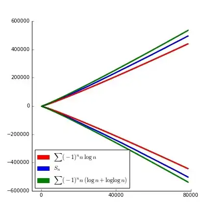

As we can see, $\sum (-1)^n n (\log n + \log \log n)$ grows in magnitude just a little bit more quickly. Focusing a bit on just the upper half, we get
this actually looks pretty much the same

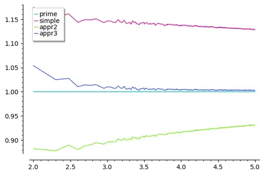

The prime number theorem gives multiple approximations of the prime number count. The simplest is just that the number of primes up to $n$ is $\pi(n)\approx n/\ln n$, which leads to $p_n\approx n\ln n$. However, this is not very accurate.
A somewhat better approximation is $p_n/n\approx\ln n+\ln\ln n$, and an even better one being $p_n/n\approx\ln n + \ln\ln n - 1$, with these two providing upper and lower bounds for $n\ge6$.

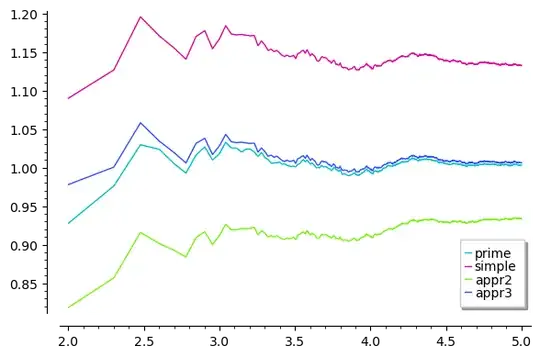

While these different approximations are all asymptotically equivalent in the sense that their ratios approach 1 as $n$ increases, convergence is slow due to the logarithmic terms. Plotting the ratios $\text{prime}(n)=p_n$ divided by $\text{simple}(n)=n\ln n$, $\text{appr2}(n)=n(\ln n+\ln\ln n)$, $\text{appr3}(n)=n(\ln n+\ln\ln n-1)$, and using $\log_{10} n$ on the $x$-axis illustrates this: Ratios of primes to different approximations, log-10 scale on x-axis
Due to the logarithmic $x$-axis, it is more clear that the ratios are approaching 1: when using a linear scale, it approaches so slowly that it may appear to converge to some number other than 1.
The similar ratios for $s_n$, which I plot instead of the ratios for $S_n$, show some additional fluctuation which is due to the alternating sum of the prime gaps: this basically acts as noise similar to a Brownian motion. The plot contains $s_n/p_n$ (prime) as well as ratios $s_n/\text{appr}(n)$ for the same functions as above. enter image description here
