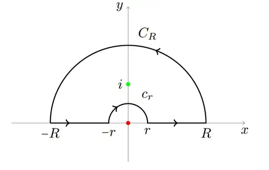

Integrate the following function
$$f(z) = \frac{e^{i\log(z)}}{z^2+1}$$
Around a semi-circle in the upper half place. Where we avoid the branch point at $z=0$ by a semi-circle. We assume that the branch cut is taken on the negative imaginary axis.
$$\int^{-r}_{-R}f(z) \,dz +\int^{R}_{r}f(z) \,dz+ \int_{C_R}f(z)\,dz+\int_{c_r}f(z)\,dz =2\pi i \mathrm{Res}(f,i)$$

The Tikz code for the contour drawing
\begin{tikzpicture}[decoration={markings,
   mark=at position 0.5cm with {\arrow[line width=1pt]{>}},
   mark=at position 2cm with {\arrow[line width=1pt]{>}},
   mark=at position 3.85cm with {\arrow[line width=1pt]{>}},
   mark=at position 7cm with {\arrow[line width=1pt]{>}}
   % The axes
   \draw[help lines,->] (-3,0) -- (3,0) coordinate (xaxis);
   \draw[help lines,->] (0,-1) -- (0,3) coordinate (yaxis);
   % The path
   \path[draw,line width=0.8pt,postaction=decorate] (-2,0) node[below] {$\minus
   R$} -- (-0.5,0) node[below] {$\minus r$} -- (-0.5,0) arc (180:0:0.5) --
   (0.5,0) node[below] {$r$} -- (2,0) node[below] {$R$} arc (0:180:2);
   % The labels
   \node[below] at (xaxis) {$x$};
   \node[left] at (yaxis) {$y$};
   \node at (0.5,0.7) {$c_{r}$};
   \node at (0.5,2.3) {$C_{R}$};
   \node at (-0.2,1) {$i$};
   \draw[red,fill=red] (0,0) circle (.3ex);
   \draw[green,fill=green] (0,1) circle (.3ex);
   \end{tikzpicture}
