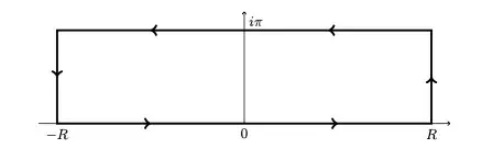

Here is another approach based in Calculus of residues.
$f(x)=\frac{1}{\operatorname{cosh}(x)}=\frac{2}{e^x+e^{-x}}$ is an even function and \begin{align*} |f(x)|=\frac{2e^{-|x|}}{1+e^{-2|x|}}\leq2e^{-|x|}\in L_1(\mathbb{R}) \end{align*} It follows that \begin{align*} \int_{\mathbb{R}}e^{-i2\pi tx}f(x)\,dx=\int_{\mathbb{R}}\cos(2\pi tx)f(x)\,dx \end{align*} Consider the contour $C_R$ joining the points $-R$, $R$, $R+i\pi$, and $-R+i\pi$ as in figure below
The function $\phi(z)=\frac{2\cos(2\pi tz)}{e^z+e^{-z}}$ has only one pole inside the bounded region bounded by $C_R$ at $z=\frac{\pi}{2}i$. Hence \begin{align} \int_{C_R}\frac{2\cos(2\pi tz)}{e^z+e^{-z}}\,dz&=2\pi i \operatorname{Re}_{i\pi/2}(\phi)=2\pi i\lim_{z\rightarrow\pi i/2}(z-i\frac{\pi}{2})\phi(z)\\ &=\pi\big(e^{\pi^2t}+e^{-\pi^2t}\big) \end{align} Since $f$ is even, the countour integral above can be expressed as $$\begin{align} \int_{C_R}\phi(z)\,dz&=\int^R_{-R}\phi(x)\,dx+i\int^\pi_0\phi(R+ix)\,dx-\int^R_{-R}\phi(x+i\pi)\,dx \\ &\quad -i\int^\pi_0\phi(-R+ix)\,dx \\ &=\frac12 (2+e^{2\pi^2t}+e^{-2\pi^2t})\int^R_{-R}\phi(t)\,dt+ \\ &\quad i\int^\pi_0\frac{e^{2\pi itR}e^{-2\pi tx}+e^{-2\pi itR}e^{2\pi tx}}{e^{R}e^{itx}+e^{-R}e^{-itx}}\,dx \\ &\quad -i\int^\pi_0\frac{e^{-2\pi itR}e^{-2\pi tx}+e^{2\pi itR}e^{2\pi tx}}{e^{-R}e^{itx}+e^{R}e^{-itx}}\,dx \end{align} $$ Letting $R\rightarrow\infty$ and applying dominated convergence yields \begin{align} \frac12\big(e^{\pi^2t}+e^{-\pi^2t}\big)^2\widehat{f}(t)=\pi(e^{\pi^2t}+e^{-\pi^2t}) \end{align} whence we ontain $$\widehat{f}(t)=\pi\operatorname{sech}(\pi^2t)$$
Mittens
  • 46,352
