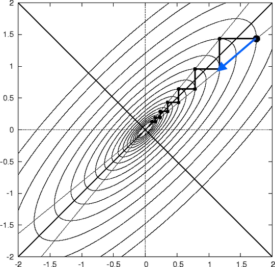

I understand that the gradient is the direction of steepest descent (ref: Why is gradient the direction of steepest ascent? and Gradient of a function as the direction of steepest ascent/descent).
However, I am not able to visualize it.
The Blue arrow is the one pointing towards minima/maxima. The gradient (black arrow) is not and that's why we have this zig-zag motion.
Then how come gradient is the direction of steepest descent/ascent?
I have a related question: Why does gradient ascent/descent have zig-zag motion?

    The gradient doesn't point to the function's maximum, but to a direction that locally if you go in that direction the function will change the most – Ofek Gillon May 05 '17 at 22:55
  • I don't personally think of the gradient that way. I think of the gradient as the slope in the x direction and the slope in the y direction. You can prove it is the same as the greatest slope direction by dotting with $[\cos(\theta), \sin(\theta)] $and using calculus to solve for greatest incline. – Kaynex May 05 '17 at 22:56

    If the gradient always pointed to the minimum, then it would also always point away from the maximum. But satisfying both of these constraints (for a function having both one maximum and one minimum) is of course impossibly as soon as min, max, and current position are not collinear. – Hagen von Eitzen May 06 '17 at 12:41
  • I think your black line segments are simply incorrect in the graphic. – Greg Martin May 06 '17 at 17:21

Although the gradient vector is defined at every point, it is really a local concept.
At any given point, it tells you the direction in which the function changes with the greatest rate. If you think of the function as height, then it gives the direction in which the ground is steepest.
As soon as you move an inch, the ground changes and the steepest direction changes.
Instead of the black zig-zag, you need an integral curve of the gradient vector field.

    @TheWanderer: Each arrow of the black zig-zag is (or should be) infinitesimally long. Or to put it another way, the black zig-zag is an overly coarse sampling of what would, at high enough resolution, be a smooth curve. – Tim Pederick May 06 '17 at 05:15
    @TheWanderer At every point there is a gradient vector. An integral curve is a curve that is tangent to these gradient vectors at all of its points. Instead of making big steps like the black zig-zag, move a tiny amount in the direction of the gradient. You've moved so the gradient vector has (probably) changed. Now move a tiny bit in the new direction. Look at where the new vector is pointing then move a tiny bit in that direction, etc. If your steps are small enough then you'll get something that looks like a curve. https://upload.wikimedia.org/wikipedia/commons/5/5a/Slope_Field.png – Fly by Night May 08 '17 at 18:49

Your black lines are not gradient lines at all. The gradient should be perpendicular to the contour lines at every point. Even in an ellipsoidal valley, the gradient will not point to the lowest point, but it will point much closer to it than your picture indicates.
A function minimizer that follows the local gradient has to take a finite sized step in the direction of the gradient, then find the gradient at the new location to take the next step. Often evaluating the gradient is very expensive and you want to do it as few times as possible. One approach is then to follow the gradient from your current point as far as the function stops decreasing, then stop, evaluate the local gradient, and set off in that direction. If that is your strategy, each new direction will be at a right angle to the prior direction. If the new gradient were not perpendicular to the old direction of travel, you could decrease the function by moving farther or not so far in the old direction of travel. You only change direction when you are at a local minimum in the direction you are going.
