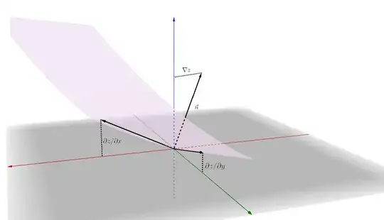

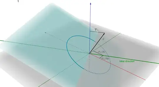

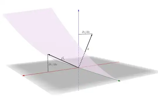

I know this is an old question, and it already has many great answers, but I still think there is more geometric intuition that can be added.
In this answer, we consider for simplicity the surface $z = f(x,y)$ and imagine taking the gradient of $z$ at the origin. Let the $xy$-plane be $\Pi$ and let the tangent plane to the surface at the origin by $\Pi'$.
Now, let $$ \vec{D_x} = \left( \begin{array}{c} 1 \\ 0 \\ \partial z / \partial x \end{array} \right), \quad \vec{D_y} = \left( \begin{array}{c} 0 \\ 1 \\ \partial z / \partial y \end{array} \right) $$ be the tangent vectors in the $x$ and $y$ directions (i.e. the basis of $\Pi'$). Then the normal to $\Pi'$ by the cross product is $$ \vec{n} = \left( \begin{array}{c} - \partial z / \partial x \\ - \partial z / \partial y \\ 1 \end{array} \right) $$ How did the $ \partial z / \partial x $ from $\vec{Dx}$ get into the first component of $\vec{n}$? That becomes clear when you look at this picture, and imagine $\Pi$ rotating to become $\Pi'$ Tangent vector and normal vector to a surface Note that I have drawn a surface with $\partial z / \partial y = 0$ just for simplicity. You will notice that the normal vector contains $ - \partial z / \partial x $ because $\vec{k}$ 'rotates' by that much in the $x$ direction to point along $\vec{n}$, a bit like turning a joystick to rotate $\Pi$ onto $\Pi'$. Notice also that this means the $y$-axis is the axis of rotation. With this simplified geometry, you can imagine why moving through the tangent plane in the direction of the $x$ axis gives the greatest change in $z$ (rotate $\vec{D_x}$ in a circle: the tip can only lose altitude).
If we nudge the curve up a bit with respect to $y$ (add some $\partial y / \partial z$) then $\vec{n}$ would be nudged away in the $y$ direction and the ideal direction would correspondingly get nudged towards us in the $y$ direction, as below.
Tangent vector and normal vector with dy added
And here is the picture from a different perspective with a unit circle in the tangent plane drawn, which hopefully helps further elucidate the relationship between the ideal direction and the values of $\partial z / \partial x$ and $\partial z / \partial y$ (i.e. $\nabla z$). I have removed the surface entirely.
tangent plane in perspective
The intuitions obviously break down in higher dimensions and we must finally surrender to analysis (Cauchy Schwarz or Taylor expansions) but in 3D at least we can get a sense of what the analysis is telling us.
