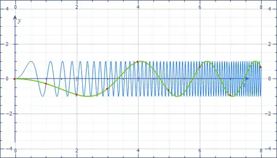

This is the phenomenon known as aliasing, caused to the fact that you are sampling a fast-varying signal with a too low frequency. It tends to create replicas of the original signal, but dilated in time.
When $a$ is close to $2m\pi$, we have at integers
$$\sin an^2=\sin(a-2m\pi)n^2$$
which is a replica of the original function with the smaller coefficient $a'=a-2m\pi$, and this is similar to a time dilation with
$$n'=\sqrt{\frac{a'}a}n$$ so that
$$\sin an^2=\sin an'^2.$$
As you can check on the plot, the blue and green curve coincide at integers ($a=6, a'=6-2\pi$).
The other patterns are similarly obtained with a phase shift (such as the values at half-integers, corresponding to $\cos a'n^2$).
  • Thanks for your enlightning answer. Do I understand your diagram correctly: the blue and green curves coincide only approximately? (Will they coincide increasingly better for $x \rightarrow \infty$?) Why then are the patterns I found so accurate? – Hans-Peter Stricker Apr 20 '17 at 13:28
    @HansStricker No, they coincide exactly at integers. –  Apr 20 '17 at 13:36
  • Ah, now I see (and start understanding)! – Hans-Peter Stricker Apr 20 '17 at 14:04

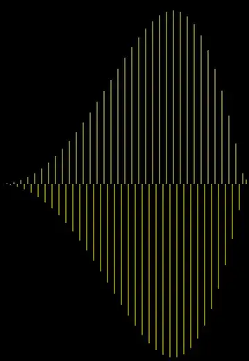

The most prominent recurring pattern is the first peak of $f(x) = \sin(a x^2)$, e.g. for $b = 5000$:
enter image description here enter image description here enter image description here
Let's take as an example the third of these patterns which is found exactly in the middle of the period of $f(x) = \sin(a x^2)$, i.e. at $x_0 = b/2$.
Enlarged, it looks like this:
We find:
$$\sin(a (2x)^2) = \sin(a (x_0 + 2x)^2) = \sin(a (x_0^2 + 4x_0x + 4x^2)) = $$
$$\sin(ax_0^2 +4ax_0x + 4ax^2) = \sin(\pi b/4 + 2\pi bx + 4a x^2) = \sin(4a x^2)$$
which holds when $b$ is divisible by $8$. A similar calculation shows that in this case
$$\sin(a (2x+1)^2) = -\sin(a (x_0 + 2x+1)^2)$$

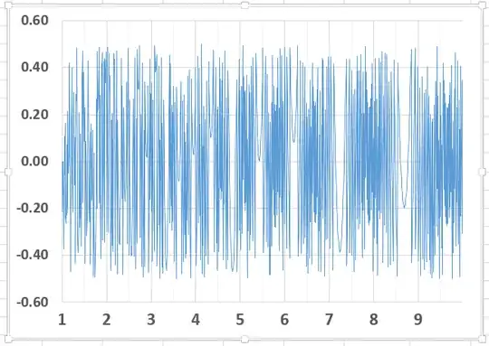

I found aliasing in a log table. Just use Excel to plot the error in a four place table with E(x)= Round(Log(x),4)-Log(x) for all 9000 values from 1 to 10. The values of the error will vary from -0.5E-4 ro +0.5E-4. The plot will have white vertical stripes where the slope of the log function is 1/4, 1/5, etc.
richard1941
  • 1,051
  • Could you please shortly explain why this is so? – Hans-Peter Stricker Apr 26 '17 at 13:51
    When the slope of the log function is just right, several successive values of the error are the same. This prevents the plot from filling the space and creates the white stripes you see at about 8.7, 7.2, 6.2, 5.4, etc. Something similar can happen with almost any differentiable function. – richard1941 Apr 28 '17 at 05:50
