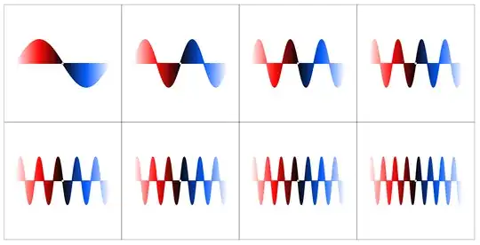

The plots of $\sin(kx)$ over the real line are somehow boring and look essentially all the same:

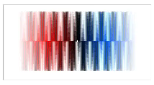

For larger $k$ you cannot easily tell which $k$ it is (not only due to Moiré effects):

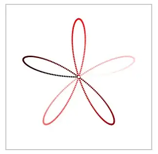

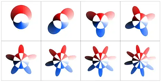

But when plotting $\sin(kx)$ over the unit circle by
$$x(t) = \cos(t) (1 + \sin(kt))$$ $$y(t) = \sin(t) (1 + \sin(kt))$$
interesting patterns emerge, e.g. for $k = 1,2,\dots,8$

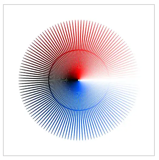

Even for larger $k$ one still could tell $k$:

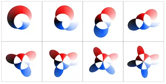

Furthermore you can see specific effects of rational frequencies $k$ which are invisible in the linear plots. Here are the plots for $k=\frac{2n +1}{4}$ with $n = 1,2,\dots,8$:

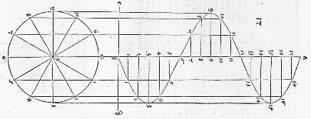

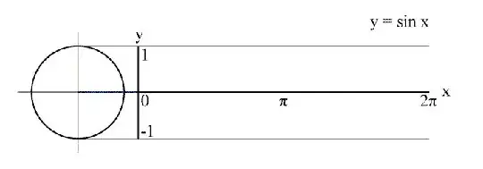

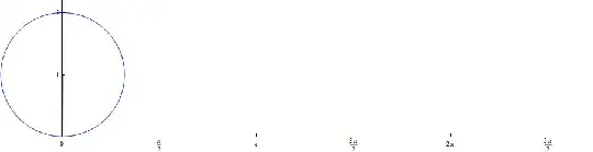

The main advantage of the linear plot of $\sin(kx)$ is that it has a simple geometrical interpretation resp. construction: It's the plot of the y-coordinate of a point which rotates with constant speed $k$ on the fixed unit circle:
Alternatively, you can look at the sine as the projection of a helix seen from the side. This was the idea behind one of the earliest depictions of the sine found at Dürer:

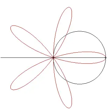

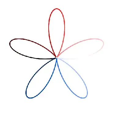

Thanks to Yves Danoust's hint to Grandi's roses I found this "answer without words" best fitting to my question:
– even though I'm not quite sure how to choose the parameters (radius of the circle, rotation speeds of line and circle) to exactly reproduce my plot:
– and even though I don't see clearly what happens. As Robert Ferréol describes it on his web page on Grandi's roses:
The roses can also be obtained as the trajectories of the second intersection point between a line and a circle in uniform rotation around one of their points.

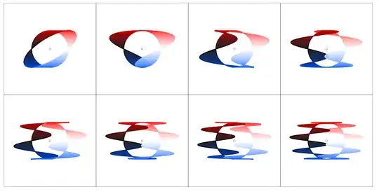

The difference between Grandi's rose and my plot is the order, in which the curve is drawn: not lobe by lobe, but as a rose. This difference vanishes, when we plot $\sin(e^{ik\varphi})$ not over the circle (as the base line), but from the origin. Here for $0 \leq \varphi < \pi$ (left) and $\pi < \varphi < 2\pi$ (right):
enter image description hereenter image description here
  • better you take just a ray from the origin: then it is easier to controll the parameters – G Cab Jan 30 '19 at 14:58
  • @GCab: Instead of what? Don't I need the whole line through the origin? And how would it help me to control the parameters? (Note that it was not me who created the animated gif.) – Hans-Peter Stricker Jan 30 '19 at 15:01
  • judging by eye from the animation, that's constructed by crossing the entire line ($\pm \rho$) with the circle. If you take instead only the ray, then the ratio of the two angular speeds will govern (better) the number of lobes. – G Cab Jan 30 '19 at 15:50
