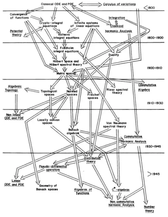

I've added a chart of development from Dieudonne's "A History of Functional Analysis" so that you can see how the infinite-dimensional gave rise to the finite-dimensional. This is very upside down, compared to most Math development. The most abstract came first and filtered down for a long before reversing course. enter image description here

    Good to make the point that Sturm-Liouville and other eigenfunction expansion ideas/problems predated "finite-dimensional linear algebra". – paul garrett Apr 19 '17 at 21:48
  • @paulgarrett : Thank you, I added some emphasis on that in the first paragraph just now. It really should be stressed. – Disintegrating By Parts Apr 19 '17 at 21:56
  • @paulgarrett : I added the Historical chart of development that shows just how upside down this development has been. – Disintegrating By Parts Apr 19 '17 at 22:02
    Very good additions. And, of course, hilariously, in the last 50+ years Number Theory (specifically, the theory of modular/automorphic forms) has found applications for almost everything in Dieudonne's picture, not just "commutative harmonic analysis" (a.k.a. Iwasawa-Tate theory of $GL(1)$ L-functions, rewriting Hecke), due to Gelfand and his collaborators/students, then Harish-Chandra, Langlands, J. Arthur. – paul garrett Apr 19 '17 at 22:37
    @TrialAndError wow I had no idea. It's hard to think how something so intuitive as finite-dimensional linear algebra came after something so elaborate! – Euler_Salter Apr 19 '17 at 23:20
    @Euler_Salter : However, why would one have intutition to look at symmetric matrices, and their eigenvectors, and to expect a basis? Fourier's principle of superposition for the heat equation effectively defined a linear response, where you superimpose sources, and expect the response to be a superposition of responses, and you can scale sources by a scalar as well, which would be expected to scale the responses. At least there would be a regime where such operations would be valid. Linearity was abstractly defined through Physical scaling and superposition well before formal linear spaces. – Disintegrating By Parts Apr 20 '17 at 00:07
