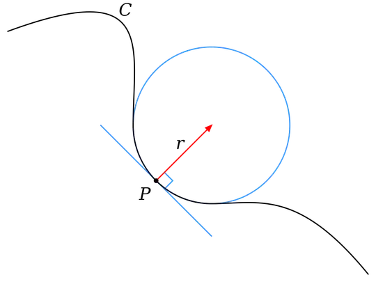

The curvature of a plane curve $C$ at a point $P$ is the reciprocal of the radius of the osculating circle.
The higher the curvature at a point on the curve, the smaller the radius of the osculating circle. A circle has the same nonzero curvature at every point. A line has zero curvature at every point.
