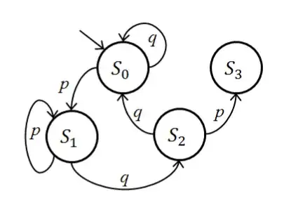

Consider a Markov Chain (MC) whose states are:
$S_0$: no flip (initial state), or the only flip was a T, or the last two flips were TT;
$S_1$: the last flip was an H;
$S_2$: the last two flips were HT;
$S_3$: the last three flips were HTH.
These states and the transitions between them are represented in the figure below: enter image description here
Such MC induce a partition of the possible strings. Let $m_{i,j}$ be the expected number of flips needed to visit state $j$ for the first time after departing from state $i$. We can write the following system of linear equations: \begin{equation} m_{0,3}=1+q.m_{0,3}+p.m_{1,3}\\ m_{1,3}=1+p.m_{1,3}+q.m_{2,3}\\ m_{2,3}=1+p.m_{3,3}+q.m_{0,3}\\ m_{3,3}=0 \end{equation} Where the first equation means that the expected number of flips to reach state $S_3$ from state $S_0$ is one flip plus whatever number is needed after this flip: with probability $q$, this flip resulted in a T, the state is again $S_0$ and the remaining expected number to reach $S_3$ continues to be the same; and, with probability $p$, this flip resulted in an H, the state becomes $S_1$, and the remaining expected number is the analogous number needed for going from $S_1$ to $S_3$. The other equations are built similarly.
Solving this system of equations and doing some mechanic algebra, we obtain $m_{0,3}=(pq+1)/(p^2q)$ as proposed.

  • That's another nice approach, which involves a bit more delicate setup but less calculation in the end. You can get something similar by "compressing" the state space of my approach by identification of "equivalent" states. For example, from the perspective of getting to HTH, THT and HHT are the same state, so they may be identified. This "compressed" version of my approach is not quite the same as yours, however, because your approach explicitly models the first three flips rather than building them into the initial distribution. – Ian Mar 04 '17 at 22:37
  • To be specific, one may compress my approach by identifying THH with HHH; THT with HHT; and HTT with TTT. HTH and TTH of course cannot be identifed. So my approach can have its state space reduced to 5 states instead of 8. – Ian Mar 04 '17 at 22:51
