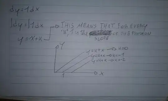

You first have to understand what a differential is. They are infinitesimal difference between successive values of a variable.
$dy=f'(x)\,dx,$ is the mathematical definition of this expression.
Of course, $f'(x)= \frac {dy}{dx}$, so you can see them as the ratio of change of y with respect of x (following the definition of a differential).
Second, integrating $dy$ yields $y+C$, and integrating $dx$ yields $x+K$, both $C$ and $K$ being constants of integration.
Hope I clarified it a bit for you
EDIT:
For the case $f'(x)=1$
This means $\frac {dy}{dx} = 1$
if you integrate both parts in $dy=1dx$ you get $y=x+k$. –
EDIT2:
Remember, the derivative of a function is the slope of the tangent line at that point, in a linear function, its the slope of the function itself.
See? for every function $y=x+k$, they all have the same slope since in a linear function, the constant denotes where the function cuts the $x$ axis, but has nothing to do with the slope of the tangent function (itself, in this case)

    Isn't integrating supposed to be the opposite operation of derivation? If we derivate x + K, we get 1, not dx. – bkoodaa Feb 13 '17 at 20:51
  • Edited my answer, take a look. – petru Feb 13 '17 at 20:56
  • Thanks, but it's still unclear on why integrating dx yields x + K. If we derivate x + K, we don't get dx, even though derivation is supposed to be the reverse operation of integration. – bkoodaa Feb 13 '17 at 21:03
  • I really like this question, you are asking what most people take for granted, im gonna edit again. – petru Feb 13 '17 at 21:06
