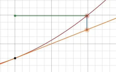

Typically, the $\frac{dy}{dx}$ notation is used to denote the derivative, which is defined as the limit we all know and love (see Arturo Magidin's answer). However, when working with differentials, one can interpret $\frac{dy}{dx}$ as a genuine ratio of two fixed quantities.
Draw a graph of some smooth function $f$ and its tangent line at $x=a$. Starting from the point $(a, f(a))$, move $dx$ units right along the tangent line (not along the graph of $f$). Let $dy$ be the corresponding change in $y$.
So, we moved $dx$ units right, $dy$ units up, and stayed on the tangent line. Therefore the slope of the tangent line is exactly $\frac{dy}{dx}$. However, the slope of the tangent at $x=a$ is also given by $f'(a)$, hence the equation
$$\frac{dy}{dx} = f'(a)$$
holds when $dy$ and $dx$ are interpreted as fixed, finite changes in the two variables $x$ and $y$. In this context, we are not taking a limit on the left hand side of this equation, and $\frac{dy}{dx}$ is a genuine ratio of two fixed quantities. This is why we can then write $dy = f'(a) dx$.

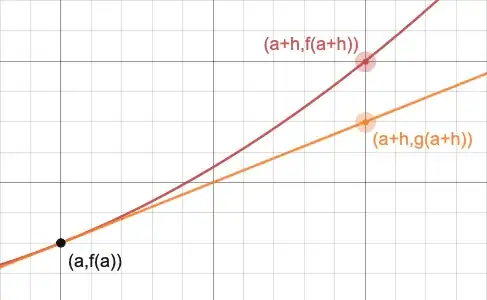

$dy/dx$ is quite possibly the most versatile piece of notation in mathematics. It can be interpreted as
  1. A shorthand for the limit of a quotient: $$ \frac{dy}{dx}=\lim_{\Delta x\to 0}\frac{\Delta y}{\Delta x} \, .$$
  2. The result of applying the derivative operator, $d/dx$, on a given expression $y$.
  3. The ratio of two infinitesimals $dy$ and $dx$ (with this interpretation made rigorous using non-standard analysis).
  4. The ratio of two differentials $dy$ and $dx$ acting along the tangent line to a given curve.
All of these interpretations are equally valid and useful in their own way. In interpretations (1) and (2), which are the most common, $dy/dx$ is not seen as a ratio, despite the fact that it often behaves as one. Interpretations (3) and (4) offer viable alternatives. Since Mikhail Katz has already given a good exposition of infinitesimals, let me focus the remainder of this answer on interpretation (4).

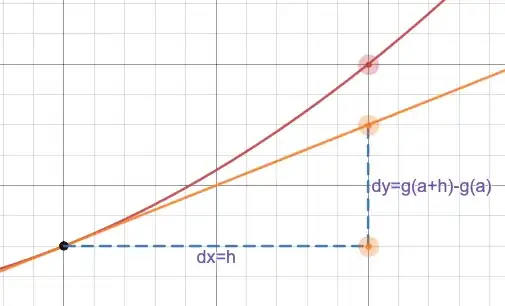

Given a curve $y=f(x)$, the equation of the line tangent to the point $(a,f(a))$ is given by $$ g(x)=f'(a)(x-a)+f(a) \, . $$ This tangent line provides us with a linear approximation of a function around a given point. For small $h$, the value of $f(a+h)$ is roughly equal to $g(a+h)$. Hence, $$ f(a+h) \approx f(a) + f'(a)h $$ The linear approximation formula has a very clear geometric meaning, where you imagine staying on the tangent line rather than the curve itself:
Staying on the tangent line
We can then define $dx=h$ and $dy=g(a+h)-g(a)$:
Differentials
Since the tangent line has a constant gradient, we have $$ \frac{dy}{dx}=\frac{g(a+h)-g(a)}{h}=g'(a)=f'(a) \, , $$ provided that $dx$ is non-zero. Here, $dy$ and $dx$ are genuine quantities that act along the tangent line to the curve, and can be manipulated like numbers becasuse they are numbers.
This notion of $dy/dx$ becomes very useful when you realise that, in a very meaningful sense, the tangent line is the best linear approximation of a function around a given point. We can turn the linear approximation formula into an exact equality by letting $r(h)$ be the remainder term: $$ f(a+h)=g(a+h)+r(h)=f(a)+f'(a)h+r(h) \, . $$ As $h\to0$, $r(h)\to0$. In fact, the remainder term satisifes a stronger condition: $$ \lim_{h \to 0}\frac{r(h)}{h}=0 \, . $$ The fact that the above limit is equal to $0$ demonstrates just how good the tangent line is at approximating the local behaviour of a function. It's not that impressive that when $h$ is small, $r(h)$ is also very small (any good approximation should have this property). What makes the tangent line unique is that when $h$ is small, $r(h)$ is orders of magnitude smaller, meaning that the 'relative error' is tiny. This relative error is showcased in the below animation, where the length of the green line is $h$, whereas the length of the blue line is $r(h)$:
Remainder term
Seen in this light, the statement $$ \frac{dy}{dx}=f'(a) $$ is an expression of equality between the quotient of two numbers $dy$ and $dx$, and the derivative $f'(a)$. It makes perfect sense to multiply both sides by $dx$, to get $$ dy=f'(a)dx \, , $$ Note that $dy+r(h)=f(a+h)-f(a)$, and so \begin{align} f(a+h)-f(a) - r(h) &= f'(a)h \\ f(a+h) &= f(a) + f'(a)h + r(h) \, , \end{align} which gives us another notion of the derivative, through the lense of linear approximation.
