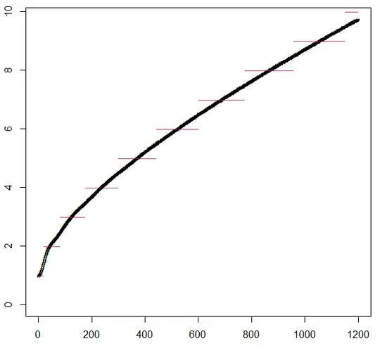

Added: This chart show simulated means of the maximum for up to $1200$ people
and rather strangely I managed empirically to get something which looks like a reasonable approximation to the mean of the maximum rounded to integers on this range with something like qpois(0.9984, lambda=(1:1200)/365) as a quantile of the Poisson distribution, illustrated in red. I would expect there to be a continuous function which did even better, though the first $40$ or so values do not appear to be on the same smooth curve as the rest of them
