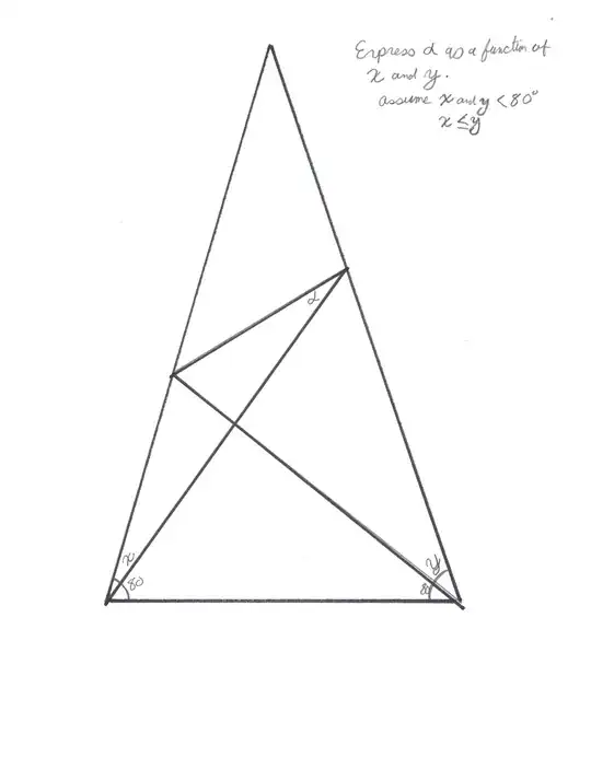

You will recognize the image below as a variation on Euclid's famous Pons Asinorum (Donkey's bridge) problem. I ran across it on a friends facebook page except that specific values had been given for x and y. I could not solve it on my own, and I ended up looking up a solution online (there are several). I realized that the solutions I was finding were constructing equilateral triangles by knowing x and y and I would never get there because I was seeking a more general solution to the problem as shown below.
This lead me to two Questions:
1) How to express the angle α in terms of x and y when x and y are not known in advance?
2) I made a number of attempts at forming a system of equations from the rules for similar triangles, and I always ended up with inadequate systems (that is ones that could not be reduced to a single solution) What is it about the nature of this problem that so resists an algebraic solution using similar triangles?

  • It might make sense to label your points and describe exactly which angle measurements describe which triple of points. Because at first glance, your $80$ (which I assume should be $80°$) seem to refer to the small angle between the horizontal line and the first sloped line. But that would form an isosceles triangle, which the bottom one is not. So it must be the base angle of the outer large triangle. Avoiding this kind of confusion is important here. – MvG Jan 24 '17 at 12:27

How to express the angle $α$ in terms of $x$ and $y$ when $x$ and $y$ are not known in advance?
One way to approach this is as follows: pick coordinates for the two endpoints of the horizontal line, e.g. $(-1,0)$ and $(1,0)$. Then you can formulate equations for the various lines originating at these points. The lower line on the left for example would be
$$\sin(80°-x)X - \cos(80°-x)Y = -\sin(80°-x)$$
The left hand side is essentially the normal vector of the line. If the line has angle zero against the horizontal, you can imagine the normal pointing down, i.e. $(0,-1)$. For an angle of $90°$ that angle would move from down to right, i.e. $(1,0)$. So we can use $(\sin\varphi,-\cos\varphi)$ here. At the right point, where the angle is measured against the left direction not the right, you'd rather use
$$\sin(80°-y)X + \cos(80°-y)Y = \sin(80°-y)$$
The outer two lines are even simpler:
\begin{align*} \sin(80°)X - \cos(80°)Y &= -\sin(80°) \\ \sin(80°)X + \cos(80°)Y &= \sin(80°) \end{align*}
Now you have coordinates for the lines, and can set up systems of equations to obtain the coordinates of the points of intersection. Then you can go about computing the angle $\alpha$ at that one point of intersection. One typical approach would be taking either two difference vectors between points, or two normal vectors of two lines, and then computing the dot product between these. Since the dot product is proportional to the cosine of the angle, you can divide the dot product by the lengths of the vectors, take the arc cosine of that and thus find the angle.

Recall first of all that in a triangle with base $a$ and base angles $\beta$, $\gamma$, the altitude can be expressed as $a/(\cot\beta+\cot\gamma)$. This can be easily proved by the sine rule, for instance.
Consider now our triangle below and set $AB=l$. By the above rule we get then $$ DH={l\over\cot(80°)+\cot(80°-x)}={l\over\tan(10°)+\tan(10°+x)}, \quad EG={l\over\tan(10°)+\tan(10°+y)}. $$ In addition we have $$ EF=GH=l-EG\tan10°-DH\tan10°, $$ and from triangle $DEF$ one gets, after some algebra: $$ \tan(\alpha+10°+x)={EF\over DH-EG}={\tan^2 10°-\tan(10°+x)\tan(10°+y)\over\tan(10°+x)-\tan(10°+y)}. $$
