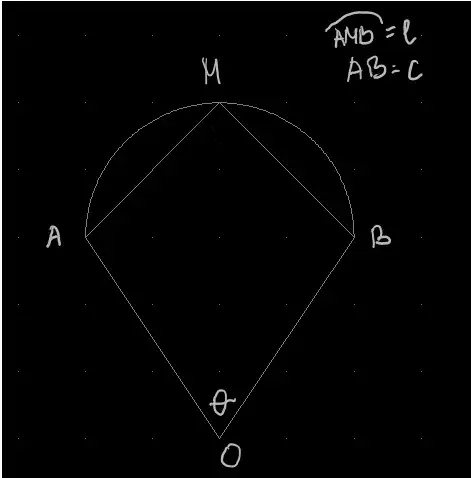

I have two points. I need to draw an arc ($<180$°) between them, and I know how long it should be, but nothing else about it.
Knowing either the radius length or the coordinates of the center point of the circle should be enough to draw it directly. I could also calculate the radius if I knew the subtended angle θ. But I don't know how to calculate either of these.
I know that somebody answered a similar question a while ago. But for some reason, the formula they give for the answer includes θ. Maybe there is an easy way to calculate it and my knowledge is just too rusty, but I can't solve my problem with this information.
I tried deriving an answer by myself, but arrived at an equation containing both an angle's cosine and the angle squared, and I don't know how to solve such an equation. Besides, there is probably an easier way than what I used.
It is OK if the answer is derived by using trigonometry, analytical geometry or anything else, as long as I can use a pocket calculator to get my radius/coordinates. But if you don't want to lose me along the way, it would be nice if you could use calculations at undergraduate level.
Here is a drawing of what I mean: enter image description here

If $r$ is the radius then you have presumably found, as Isaac did, that $l=r\theta$ and $\frac{c}{2}=r \sin(\theta/2).$ You could eliminate $\theta$ to get $$2r \sin\left(\frac{l}{2r}\right) = c.$$ That you can solve for $r$ using numerical methods.

As you said you had, I arrive at an equation that cannot be solved algebraically, $\cos\frac\theta 2=\frac{c\theta}{2l}$, so I suspect that there is no algebraic solution, only a numerical approximation.

I think that this question can be answered very simply as follows: from the equations for the segment and section of a circle, we have the chord length, $c$ and arc length, $s$
$$ c=2R\sin\frac{\theta}{2}\\ \theta=\frac{s}{R} $$
We can determine $\theta$ by iterating to find
$$\frac{c}{s}-\text{sinc}\frac{\theta}{2}=0$$
where $\text{sinc}(x)=\sin(x)/x$. And, of course, $R=s/\theta$. I have verified this numerically for random points in the plane. Not mentioned in the original question is how to find the location of the circle center. The normal distance form the center of the chord to the origin is $d=R\cos(\theta/2)$.
