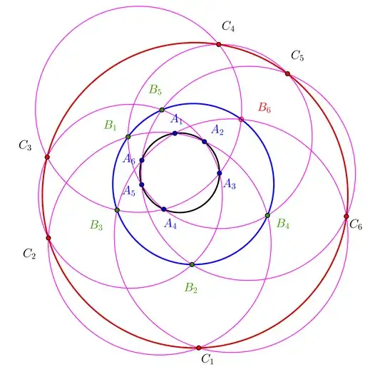

I am looking for a proof of a problem as follows:
Let six points $A_1, A_2, A_3, A_4, A_5, A_6$ lie on a circle. Define $C(A,B)$ be any circle through points $A, B$. Let $C(A_i,A_{i+1}) \cap C(A_{i+3}, A_{i+4}) = B_i, B_{i+3}$ we take modulo 6. Let $B_1, B_2, B_3, B_4, B_5$ lie on a circle $(C)$. Let $C(A_i,A_{i+1}) \cap C(A_{i+1}, A_{i+2}) = C_{i+1}$. Show that $B_6$ also lie on the circle $(C)$ and six points $C_1, C_2, C_3, C_4, C_5, C_6$ lie on a circle.

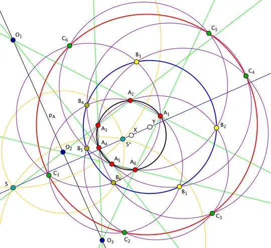

By Pascal's theorem the three intersection points $$O_1 = A_1A_2 \cap A_4A_5 \, , \,\,\, O_2 = A_2A_3 \cap A_5A_6 \, , \,\,\, O_3 = A_3A_4 \cap A_6A_1$$ lie on a common line (the Pascal's line) $p_A$. Draw the three circles $k_1\,, \,\, k_2\,,\,\, k_3$ centered at the points $O_1,\,O_2\,O_3$ respectively and each of them orthogonal to the circle $k_A$ (the circle passing through the points $A_1, A_2, A_3, A_4, A_5, A_6$). Then, $k_1, k_2, k_3$ intersect at two common points $S$ and $S^*$, i.e. the circles $k_1, k_2, k_3$ are coaxial (have a common radical axis, passing through the points $S$ and $S^*$, and orthogonal to the Pascal line $p_A$).
From now on, by $k(ABC)$ I denote the unique circle (or a straight line) passing through the points $A, B, C$.
Lemma 1. Let $k_B$ be a circle different from $k_A$. Take an arbitrary point $B_1$ from $k_B$ and draw the pair of circles $k(B_1A_1A_2)$ and $k(B_1A_4A_5)$. Then the second intersection point $B_4 (\neq B_1)$ of $k(B_1A_1A_2)$ and $k(B_1A_4A_5)$ also lies on $k_B$ if and only if $k_B$ orthogonal to circle $k_1$.
Proof: By construction of circle $k_1$, if one performs an inversion with respect to $k_1$, then $A_1$ is mapped to $A_2$ and $A_4$ is mapped to $A_5$. Thus, circle $k(B_1A_1A_2)$ is mapped to itself and is therefore orthogonal to $k_1$. Analogously, circles $k(B_1A_4A_5)$ is also orthogonal to $k_1$. By the radical axis theorem applied to the circles $k_A, \, k(B_1A_1A_2)$ and $k(B_1A_4A_5)$, the three radical axes $B_1B_2, \, A_1A_2$ and $A_4A_5$ intersect at a common point, which is $O_1 = A_1A_2 \cap A_4A_5$ -- the center of circle $k_1$. Therefore, point $B_1$ is mapped to $B_4$ under the inversion with respect to circle $k_1$. Consequently, if $k_B$ is orthogonal to $k_1$, since $B_1 \in k_B$ its inversive image $B_4$ also lies on $k_B$. Conversely, if both $B_1$ and $B_4$ lie on $k_B$, then the circle $k_B$ is orthogonal to $k_1$.
Lemma 2. Let $B_1$ and $B_2$ be two different points in the plane. Let the pair of circles $k(B_1A_1A_2)$ and $k(B_1A_4A_5)$ intersect again at the second point $B_4 (\neq B_1)$, and let the pair of circles $k(B_2A_2A_3)$ and $k(B_2A_5A_6)$ intersect again at the second point $B_5 (\neq B_2)$. Then the four points $B_1, B_2, B_4, B_5$ lie on a common circle $k_B$ if and only if $k_B$ is orthogonal to the three circles $k_1, k_2, k_3$.
Proof: Let $k_B$ be a circle passing through points $B_1$ and $B_2$. By Lemma 1, points $B_4$ and $B_5$ also lie on $k_B$ if and only if $k_B$ is orthogonal to both circles $k_1$ and $k_2$. Therefore, the radical axis $SS^*$ of $k_1$ and $k_2$ passes through the center of $k_B$ whenever $k_B$ is orthogonal to $k_1$ and $k_2$. However, by construction, $SS^*$ is a common radical axis for all three circles $k_1, \, k_2$ and $k_3$ which means that $k_B$ is orthogonal to $k_3$ as well.
Corollary 3. In the setting of Lemma 2, let the four points $B_1, B_2, B_4, B_5$ lie on a common circle $k_B$. If $B_3$ is another (arbitrary) point on $k_B$, then the second intersection point $B_6$ of the pair of circles $k(B_3A_3A_4)$ and $k(B_3A_6A_1)$ also lies on $k_B$.
Proof: Follows directly from Lemma 2.
From now on, I am in the setting of Lemma 2, Corollary 3 and the statement of the original problem, where points $A_1, A_2, A_3, A_4, A_5, A_6$ lie on the circle $k_A$ and the points $B_1, B_2, B_3, B_4, B_5, B_6$ lie on the circle $k_B$. In the notations of the original problem $C(A_6,A_1)$ is the circle $k(B_3A_6A_1)$, the circle $C(A_1,A_2)$ is the circle $k(B_1A_1A_2)$, the circle $C(A_5,A_6)$ is the circle $k(B_2A_5A_6)$ etc.
Lemma 4. The four lines $B_1B_4,\, B_2B_5,\, A_2C_2$ and $A_5C_5$ intersect in a common point $D$.
Proof: Define $D$ as the intersection point of the lines $B_1B_4$ and $B_2B_5$. Let us look at the three circles $k_B, \, C(A_1A_2)$ and $C(A_2,A_3)$, where $C_2$ is the second point of intersection of $C(A_1A_2)$ and $C(A_2,A_3)$, the one that is different from $A_2$. Then their three corresponding radical axes $B_1B_4,\, B_2B_5$ and $A_2C_2$ intersect at the common point $D$. Analogously, the three circles $k_B, \, C(A_4A_5)$ and $C(A_5,A_6)$ define the three radical axes $B_1B_4, \, B_2B_5$ and $A_5C_5$ which intersect at the common point $D$.
Lemma 5. The four points $A_2, A_5, C_2, C_5$ lie on a common circle $k_{25}$.
Proof: As a consequence of Lemma 4, the two chords $B_1B_4$ and $A_2C_2$ of the circle $C(A_1,A_2)$ satisfy $$B_1D \cdot DB_4 = A_2D \cdot DC_2.$$ Similarly, again by Lemma 4, the two chords $B_1B_4$ and $A_5C_5$ of the circle $C(A_4,A_5)$ satisfy $$B_1D \cdot DB_4 = A_5D \cdot DC_5.$$ Consequently $$ A_2D \cdot DC_2 = B_1D \cdot DB_4 = A_5D \cdot DC_5$$ which is possible if and only if the four points $A_2, A_5, C_2$ and $C_5$ lie on the the same circle, we call $k_{25}$.
Lemma 6. The four points $C_5, \, C_6, \, C_1$ and $C_2$ lie on a common circle, we call $(C)$.
Proof: It follows from Lemma 5 and Miquel's theorem applied to the circles $C(A_5,A_6), \, C(A_6,A_1), \, C(A_1, A_2), \, k_{25}$ and $k_{A}$.
Finally, we can apply Lemmas 5 and 6 consecutively first to points $A_3, \, A_6, \, C_3, \, C_6$ and second to points $A_1, \, A_4, \, C_1, \, C_4$ in order to show that first the points $C_6, \, C_1, \, C_2$ and $C_3$ lie on a common circle, which has to be again $(C)$ and second that the points $C_1, \, C_2, \, C_3$ and $C_4$ also lie on a common circle, which is $(C)$.
