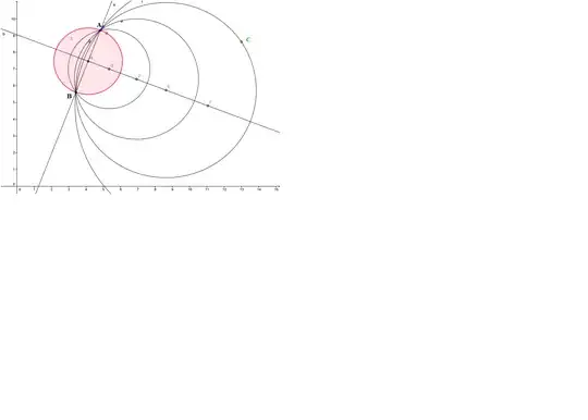

The topic is called “family of lines”.
It says, from A and B, form (using two-point form) P, the equation of AB.
It also says, form (using A and B as endpoints of diameter) S, the equation of the red circle. [There is a simple formula for doing that too.]
For different values of λ, S + λP = 0 represents a family of circles passing through A and B.
For a specific value of λ, that equation will be the circle that passes through C.
The co-ordinates of C can be used to determine that value of λ. Hence, the equation of the circle passing through A, B, C is known.
