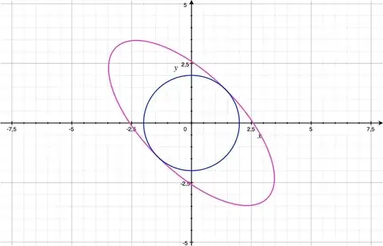

You can always try to write it in polar coordinates:
$$3r^2+4r^2\sin\theta\cos\theta=20$$ $$r^2=\frac{20}{3+2\sin2\theta}\ge\frac{20}{3+2}=4$$

Hint: $4xy \le 2(x^2+y^2), 3x^2+3y^2 = 3(x^2+y^2) \implies 5(x^2+y^2) \ge 20 \implies x^2+y^2 \ge .....$

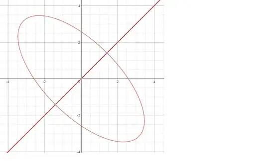

By inspection (or see this for additional reference if required), we can see that this is an ellipse with centre at origin and axes of symmetry $y=\pm x$. Substituting into the ellipse equation gives end points of minor and major axes respectively: $$\\\begin{align} 3x^2\pm 4x^2+3x^2&=20\\ 2x^2, 10x^2, &=20\\ x&=\pm\sqrt{2}, \pm\sqrt{10}\end{align}$$ Distance from origin to semi-major/semi-minor axes is given by $\sqrt{x^2+y^2}=|x|\sqrt{2}$.
Shortest distance from origin to ellipse is semi-minor axis, i.e. $$\sqrt{2}\cdot \sqrt{2}=\color{red}2$$

Taking into account that it is an ellipse with short axis $y=x$ find crossings of this line with the ellipse.
