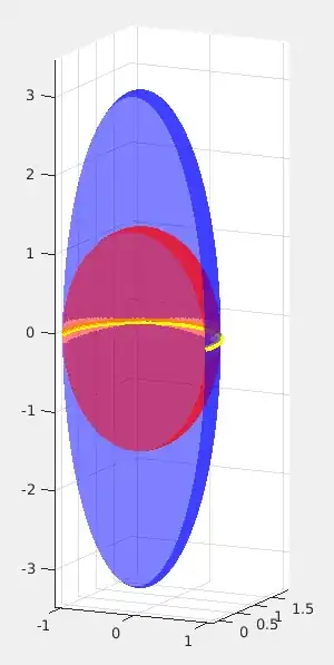

My original intention was to cast this as another (reduced) nonlinear program in which the gradients $\{\nabla h_i\}$ are linearly independent. My attempt was to try to show that $\hat{x}$ will be a local minimum of $(P.1)$ ignoring the "linearly dependent components". This is, if I solve (P.1) for all combinations of $\{A_i\}_{i=1}^m$, for example building $D$ only with the $A_i$ for separate, then by pairs, etc... then $\hat{x}$ would show up as a solution of one of those, in which the corresponding $\{\nabla h_i\}$ are linearly dependent. Is this true? The more I think about it the more I convince myself it is not the case. But what do you think? As an example of what I mean here, is the following. Consider $m=2$, $n=3$ and $A_1 = \text{diag}(1,1,0.1)$, $A_2 = \text{diag}(1,1,0.5)$. The constraints $x^TA_1x=1$, $x^TA_2x=1$ look like the red and blue surfaces here: enter image description here
Their intersection is the yellow circle. Note that points in such intersection will have linearly dependent gradients, basically since $A_1x=A_2x$ for $x$ in such interection. However, if I study (P.1) just by taking into account $A_1$, I could still find those points. Of course this is just an example that motivated my idea, but It seems not to generalize.
