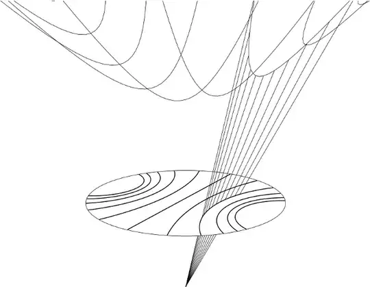

The two gnomonic projections, and stereographic projection of the sphere, are readily-visualized. Probably the least well-known projection is the conformal projection from the hyperbolic plane to the unit disk in the plane $\{z = 0\}$, using $c = (0, 0, -1)$:
Projecting the hyperboloid to the disk

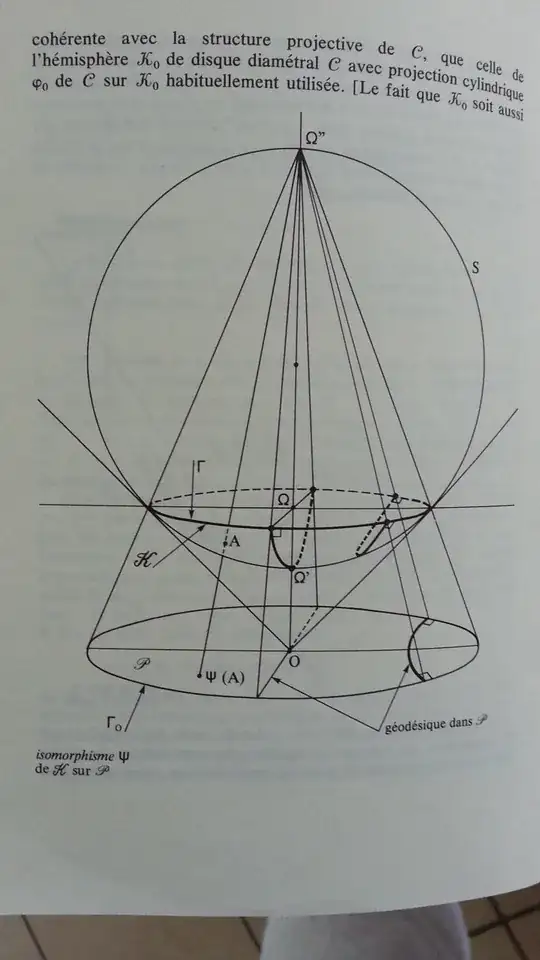

This is not a full answer, but it is the only way I can include graphical information which comes from p. 426 of a French book.
I think this figure is self-explanatory.
If you read French, this (excellent) book is "Initiation à la géométrie" by Daniel LEHMANN and Rudolphe BKOUCHE, Presses Universitaires de France,1988.
Jean Marie
