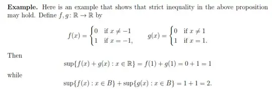

Another example for < from (http://people.reed.edu/~davidp/212.2013/handouts/sup_example.pdf)
The pdf doesn't expatiate on this, but $\sup f(x) + g(x) = 1 $ at both $x = -1, 1$.
pdf simply chagrins about $x = 1$. But at $x = -1$, $f(-1) + g(1) = 1 + 0 = 1$.
