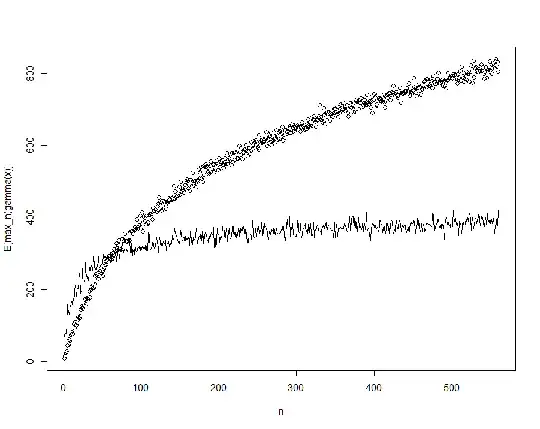

Suppose a random variable $X$ follows a Gamma distribution with parameters $\alpha$ and $\beta$ with the probability density function for $x>0$ as
$$f(x;\alpha,\beta)= \frac{\beta^\alpha}{\Gamma(\alpha)} x^{\alpha-1} \exp(-\beta x)$$
where $\Gamma(\alpha)$ represents the Gamma function. Suppose we take n samples from this distribution and only record the maximum value. For a given n, is there a general way to describe the expectation of this maximum value that we record? Below is a plot of the expectation (circles) and also the standard deviation (lines) for 1000 trials for each n draws, which produces a log-like curve with $\alpha=0.02$ and $\beta=0.0025$.

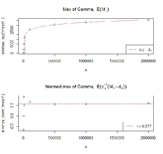

I have run 100 simulations of the max of $n = \{10^1, 10^2,10^3,10^4,10^5,5\cdot 10^5, 10^6, 2\cdot 10^6 \}$ and taken the expectation for each run, then plotted this against $n$ and added the limiting theoretical value. For the auxiliary function, the little-o part has been ignored. I have used the same parameters as in the question, i.e. $\alpha = 0.02$ and $\beta = 0.0025$.
Expectation of maxima against number of simulations

  • Thank you for the answer and providing further reading. A few further questions, how come $E[M_n]$ is independent of $n$? Is it to do with norming constants? I.e should $E[M_n]= c_n \gamma + d_n$? If so, this does not look like the plot I have above even for large n ($10^5$). Also, what about if I want to know the distribution of $M_n$, is it just a matter of multiplying/dividing the norming constants as well so that the distribution of $M_n$ is $c_n \Lambda(x) + d_n$ or am I missing something? Also, I think you left out a negative in the first definition of the Gumbel distribution. – Free_Apples Dec 19 '16 at 02:59
    @Free_Apples I have corrected some mistakes. The expectation is not independent of $n$ as you noted and it is only an asymptotic result. Such independence would only happen if $X_i$ were from the max-stable distribution themselves, i.e. $F = \Lambda$. Also, it seems like there is a mistake in the table I got the norming constants from in Embrechts et al. (1997). I got some misspecification, so I changed to the general norming constants for distributions in the $\operatorname{MDA}(\Lambda)$, which is a result on Von Mises functions. Yes, I forgot a minus in the definition of the Gumbel! Thanks! – Therkel Dec 19 '16 at 12:51
