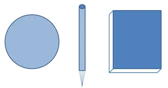

Given a circle on a paper, and a pencil and a book. Can you find the center of the circle with the pencil and the book?

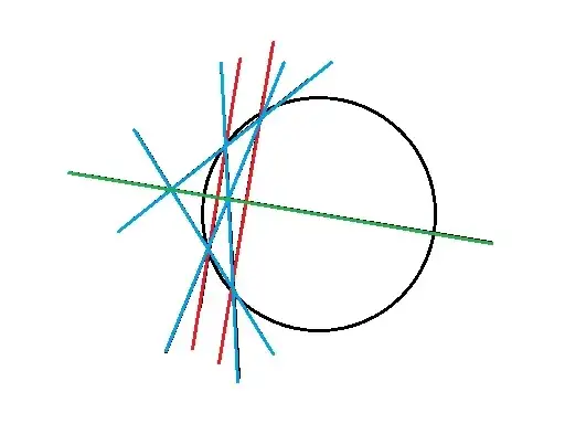

Not as simple as the accepted answer, but you have another solution:
Use the book to draw two parallel lines that cross the circle at different distances from the center to obatain 4 intersection points in the circle. Draw 4 lines connecting these points. The two points of intersection from these 4 lines define a diameter. Repeat the process with two parallels with different direction to obtain another diameter. Finally the intersection of two diameters returns the circle center.
Luis
  • 635
  • The two points of intersection from these two lines define a diameter. Why? – zdd Oct 03 '12 at 01:07
    I added an image to explain. The green line is a diameter because is perpendicular to the parallel lines (in red) and is crossing them at equal distance from both outer segments (in blue). – Luis Oct 03 '12 at 02:21
  • And by the way, it works dosen't matter the size of the book or the circle. – Luis Oct 03 '12 at 02:23
  • Excellent, this one didn't use the corner of the book, I like it! – zdd Oct 03 '12 at 03:05
    The picture makes it make a million times more sense. This one gets a +1. – AlbeyAmakiir Oct 03 '12 at 03:56
    How do you use the book to draw two parallel lines? –  Oct 03 '12 at 03:56
    @RahulNarain, hold the book so it's spine is on the circle, not it's face. But it would work even if the red lines are on opposite sides of the circle. – AlbeyAmakiir Oct 03 '12 at 03:58
    @RahulNarain The corner of book can be used to draw two parallel lines :) – Meysam Oct 03 '12 at 08:47
    This solution is far better than the accepted one, since it does not depends on perception ("put the corner of the book..." how do you know that you are really drawing a diameter?). +1 for this answer! – Barranka Oct 03 '12 at 18:59
  • If @AlbeyAmakiir's idea of using the thickness of the spine is Luis's intended solution, this entails an awkward action and depends on the circle being big enough. Alternatively, use the book to draw two perpendiculars ABC and AD, BC being a chord. Then shift the book along AD and draw EFG parallel to ABC where FG is a chord and ED is on AD. – Rosie F Dec 17 '17 at 10:04

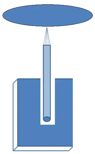

Assuming the paper contains nothing but the shape of the circle:
 1. Put eraser end of pencil on book. Or put pencil flush against side of book.
 2. Rest circle on tip of point.
 3. Circle will rest on the center.
Circle resting at center on pencil point

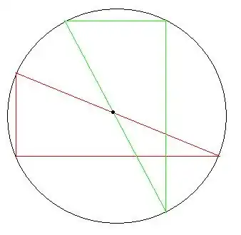

The only book I have is usually under my pillow. It has become skewed over the years - no 90 degrees joy. As a consequence I failed to have success applying the (elegant) description of Patrick Li. Moreover, my book is too small anyway to connect diametrically opposing points on the circle.
Therefore I had to revert to a more tedious approach.
Pick two points on the circle, close enough for my book's reach, connect them. Align one of the book's edges with that line, the bookcorner at one of the marked points, draw a line along the adjacent edge of the book - which is non-perpendicular to the first line. Flip the book and draw "the other" non-perpendicular line through the same point. Repeat at the other point. Connect the two intersections that the four lines make, and extend this line - by shifting one bookedge along - to complete the diameter. If the intersections are too wide apart for my book, retry with the original points closer together. Repeat all of this with two other points on the circle, to get two diameters crossing at the midpoint.
If, by some miracle, my book has straightened out again (but still is tiny compared to the circle), I will quickly find out: the two "non-perpendicular" lines at one of the initial mark-points overlap. Then, I continue the line(s) until I cross the circle at the other side; likewise at the other initial point, and I wind up with a long and narrow rectangle. Repeating that from some other location on the circle, roughly at 90 degrees along the circle from the first setup, I get two rectangles and their intersection is a small parallellogram somewhere in the middle. It's diagonals cross at the center of the circle.
Draw a right triangle inside the circle, making all vertices touch the circle.
Transform it into a rectangle.
Draw a line joining the opposite corners and you will have obtained the center of the circle
Edit: The idea is very simple:
1. Put a corner of the book touching the circle from the inside in any place.
2. Use the edges of the book for drawing the catheti of the right triangle until they intersect the circle.
3. Draw the hypotenuse using those intersections.
4. Put a corner of the book in any of those intersections overlapping one edge with the cathetus.
5. Use the other edge of the book to draw a line until it intersects the circle.
6. Draw a line joining this new intersection with the intersection opposed to the hypotenuse (right angle point).
7. The point in which this line crosses (intersects) the hypotenuse is the center of the circle.
Edit:
In fact, any rectangle inside the circle with every corner touching the circle will do the trick
Diego
  • 165
